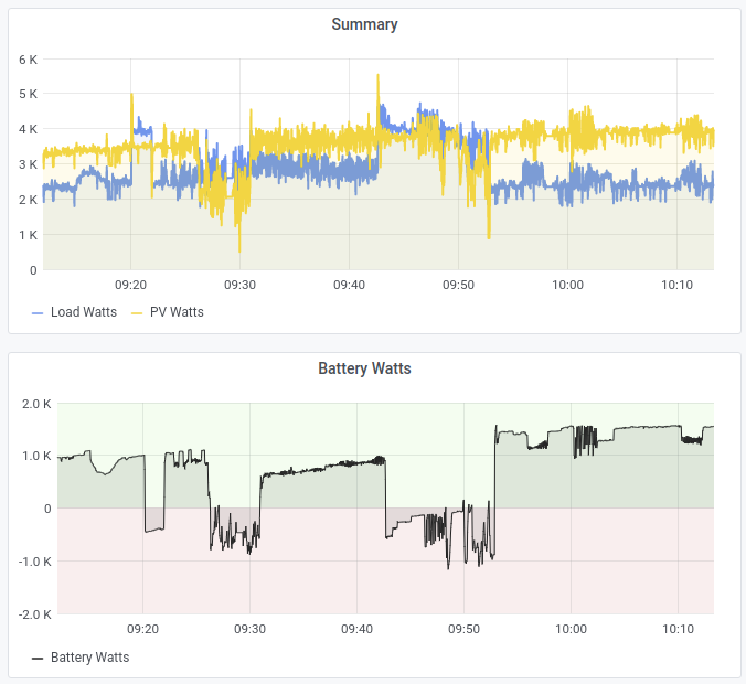

July 7, 20206 yr Hi Experts I run 2x Axpert MKS II in parallel. When they are running in Utility (aka grid or line) mode the PV watts is very stable. When running in battery mode the PV stability isn't bad, but it's not as stable as grid. In the attached image you will see the yellow line (PV) is very stable when in grid mode (where the brown grid watts is not 0). When in battery mode (brown grid watts is 0) the PV fluctuates with about 10%. Legend for attached image: Brown: Grid Yellow: PV Blue: Load Green: SOC
July 7, 20206 yr 46 minutes ago, pierre. said: When running in battery mode the PV stability isn't bad, but it's not as stable as grid. So I guess your question is: why is that so? It happens I answered a similar question just minutes ago, here. In short, I believe it's because in line mode, AC-in supplies the majority of the load power (and the loads are choppy). So nearly all the PV power goes to charging the battery, which is a smooth process, certainly compared to loads, which vary as people and thermostats turn things on and off. In battery mode, PV power is called on to supply the choppy loads as well as charge the battery.

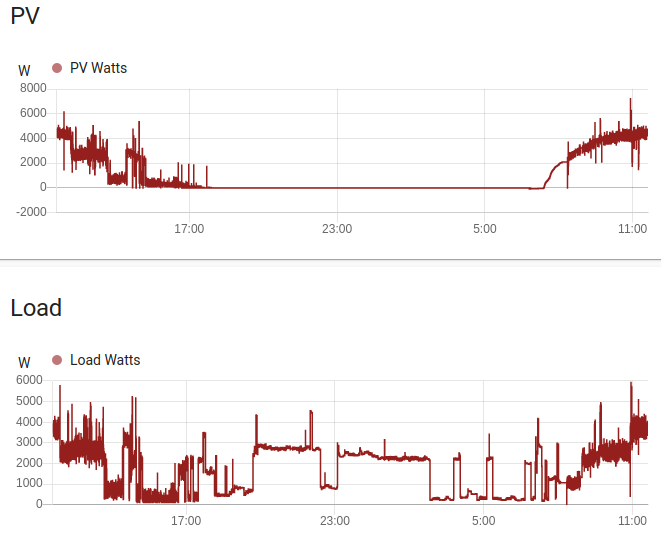

July 13, 20206 yr Author @Coulomb Now even more interesting, according to the inverter, the load also becomes unstable once it's not on grid. In the graphs below it switched to grid at 18:00 and then back to battery at 8:30: Edited July 13, 20206 yr by pierre.
July 13, 20206 yr 4 hours ago, pierre. said: according to the inverter, the load also becomes unstable once it's not on grid. I have no idea what's going on there. Is the output voltage fluctuating wildly or something? Or maybe the loads actually are steady, and it's a measurement error, and that error is triggering switches to grid, and back to battery again when the intermittent error goes away.

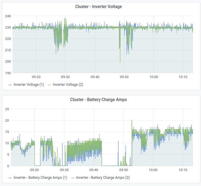

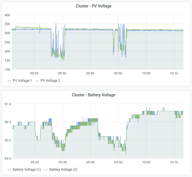

August 4, 20206 yr Author On 2020/07/14 at 2:41 AM, Coulomb said: Check to see if the battery voltage fluctuates as well. It could be that you battery is undersized or high internal resistance. Hi @Coulomb what is an undersized battery? I know the MKS II 48V manual says you need 200AH battery per inverter, but that is for lead acid right? With lithium the charge/discharge is much higher. I currently have 3x PylonTech US3000 which comes down to 220AH. I haven't sorted out the fluctuating output AC yet. I've replaced the parallel cables and made sure all cables are same length. In charts below, problem happens around 09:25 and again at 09:51. Note that I can easily cause the system to become unstable by just turning on enough appliances to match (but not exceed) the PV generation. Whats the chances a firmware update can fix this? I'm currently on 71.70 and can upgrade to 71.80 or your patched 71.80a. Edited August 4, 20206 yr by pierre.
August 5, 20206 yr 3 hours ago, pierre. said: what is an undersized battery? 220 Ah of lithium should be OK for two inverters. I see that the battery voltage varies only about 1.5%, while the output voltage varies up to 8%. I note that the PV voltage varies some 80% when the voltage goes unstable. This could be affecting the bus voltage, which will cause the inverters to struggle to maintain a steady output voltage. 3 hours ago, pierre. said: Whats the chances a firmware update can fix this? I'd be guessing, but I'll say the chances are slim. It would not hurt to try. The problem may even be a side effect of the design. Though I'd expect more problems if your PV voltage was significantly above the magic 337 V needed to generate a proper 230 V sine wave (230 x √2 + 12 V), but yours seems to be just under that value. Your battery voltage times the presumed transformer turns ratio of 1:7 comes to some 348 V minimum. My wild guess is that this means that your inverters have only a few tens of volts from the steady state PV voltage to the presumed bus voltage (around the battery voltage times 7), so there isn't much room for boosting the PV input before it raises the bus voltage. Raising the bus voltage is fine; it can go up to 450 V, but as it does, the output voltage will rise until the output voltage control system reigns it in.
