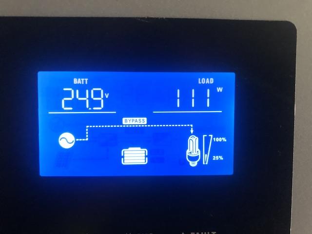

My Problem is, that the Batteries doesn’t get full. The inverter shows all the day symbol for full Battery and no current to the Battery.

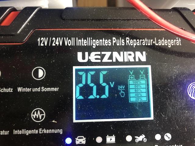

For testing, I have load my Battery with external device. The Battery shows an acid density of 1.25.
At the next morning I look at the inverter. the Inverter has switched to Main Current at the night. Now the Battery get loaded up to 70% (acid 1.20). The next day lower. The next day again lower. Up to 0% with acid 1.10.

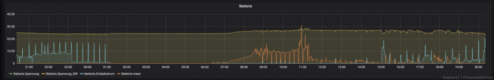

i have checked now the Voltage on the Batterie for the last 2 days.8CAD206A-5A42-4546-BE63-89A95D19B5E6.thumb.png.e0a1a7dd06223126d746f3488aa75046.png
Never more than 27V.
The Inverter voltage always shows the same voltage like my Battery Loading Device. It’s parallel connected to the batteries but without doing something. Only show voltage.
Well, that's not going to charge your battery much. Do you have adequate solar panels? Are they performing OK (not dirty, no tripped breakers, etc)?
Ok, so that's likely not the problem.

I have a second device connected to the Batteries and this shows always the same voltage like the inverter.

The inverter battery readings seem close enough; the inverter is reading a little high on charging and low on discharging, consistent with some voltage drop across cables and PCB tracks. I don't believe that's the problem now.
