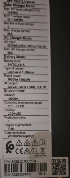

May 29, 20242 yr On 2020/12/30 at 8:24 AM, naids said: Thanks @Buyeye, let me see what that does. Hi did you come right? i have a similar issue but I have a 3kw growatt off grid inverter with a svolt 2.71 kw battery & 3 x 410w solar panels
May 29, 20242 yr 11 hours ago, shahzaz said: Hi did you come right? i have a similar issue but I have a 3kw growatt off grid inverter with a svolt 2.71 kw battery & 3 x 410w solar panels Just confirm the model of the inverter or post the sticker on the side of the inverter.
May 31, 20242 yr On 2024/05/29 at 8:14 PM, Scorp007 said: Just confirm the model of the inverter or post the sticker on the side of the inverter. Please see attached, - which setting to ensure that the only time the battery is used to supply loads is when there's no municipal supply... currently the PV supply power during the day to charge the battery & excess power to supply essential loads circuit connected to inverter... Edited June 5, 20242 yr by shahzaz update
