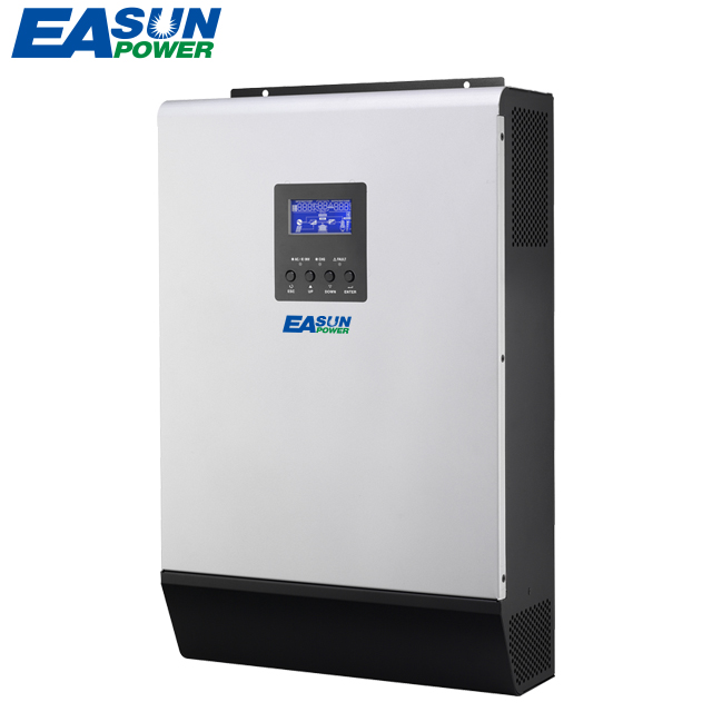

On 2024/02/10 at 6:17 PM, Rolf Gerig said:
I have encountered a similar firmware bug with my ISolar-SM-II-5KW-48 6-inverter...
Is this an Axpert MKS II? I.e. do they look like the below?
If so, sadly there is no patched firmware for this issue at present.
If not, what is the main (U1) firmware version? It seems that EASuns in the past were all Axpert clones, but they seem to have switched to being a legitimate reseller now. If so, there may be  patched firmware to solve it. Sadly, it seems that Voltronic are unable to fix this issue themselves, at least at this point in time.
