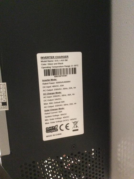

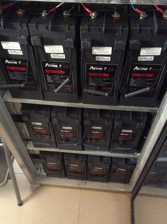

0 wolfandy Posted January 17, 2021 Share Posted January 17, 2021 21 minutes ago, Peet Welthagen said: I am not sure, were do I check if it is Axperts If you post photos from the sticker on the side of the inverters, then we should be able to help you with that. I would assume they are, but just to confirm 22 minutes ago, Peet Welthagen said: where is the best place to purchase a Raspberry Pi You can either buy the complete kit (Pi and ICC software) from the ICC website or purchase the Pi separately from e.g. here and only purchase the ICC software directly from the ICC website Which batteries are you running? Quote Link to comment Share on other sites More sharing options...

0 Peet Welthagen Posted January 17, 2021 Author Share Posted January 17, 2021 Hi @wolfandy attached is my setup, with 21 250w panels Quote Link to comment Share on other sites More sharing options...

0 wolfandy Posted January 17, 2021 Share Posted January 17, 2021 51 minutes ago, Peet Welthagen said: attached is my setup Thanks The inverter is a genuine Axpert (no clone), so ICC will work with it. One of my inverters is actually exactly the same model and built in the same month/year If you have not yet upgraded the firmware to @Coulomb's patched firmware 73.00e, then I would highly recommend doing so Quote Link to comment Share on other sites More sharing options...
