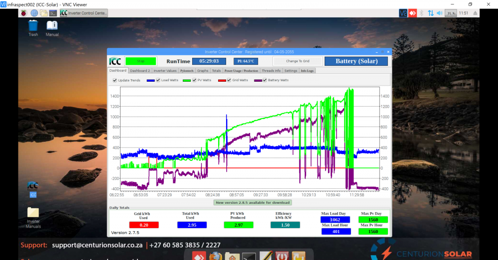

All works perfectly but once batteries read 100% the system seems to rapidly alternate between drawing off the battery and then REcharging to 100%. This is no good for the system or battery. (Or me - frying lead acids left their mark)
I attach screenshots of the symptoms and my current settings.  It is a setting problem. Somehow it does not float once charged.

You will also notice that the system no longer runs off solar - now it is discharging the battery until who knows when and in between the sun is happily wasting its rays away.
Briefly drawing from your batteries is normal. This is due to the fact that when your load increases, your MPPT simply cannot adjust output accordingly that quickly - and hence your inverter will draw from the batteries to make up the shortfall. To my understanding, this will not hurt your batteries. I am having a cloudy day, so my charts are all over the place - but you will see that I also briefly draw from the batteries regularly
Could you please post a screenshot of your Graphs -> Battery Trends charts? That will help better understand what is happening with your batteries
And maybe also the Settings -> Batteries tab please

2. I understand that sometimes the battery helps out if the solar is insufficient but mine is tripping one way then the other as if bezerk.
3. I attach further screenshots. The battery is now as it was - I reset it somewhat to test but it had no influence. I notice that the solar has now started again.
4. I made the changes to float and bulk.
