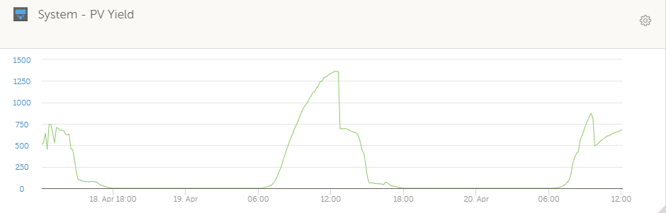

Over the last week or so I've been noticing my solar yield has dropped off sharply. I have a 2x2 array of 405w CS panels.
It looks like at some point in the day, one of the strings will stop producing. I've just pulled the fuses on the string 2 with no drop in solar yield. All 4 panels are currently in full sun; string 1 is measuring a 68-70v, while string 2 is all over the place from 22-38v.
