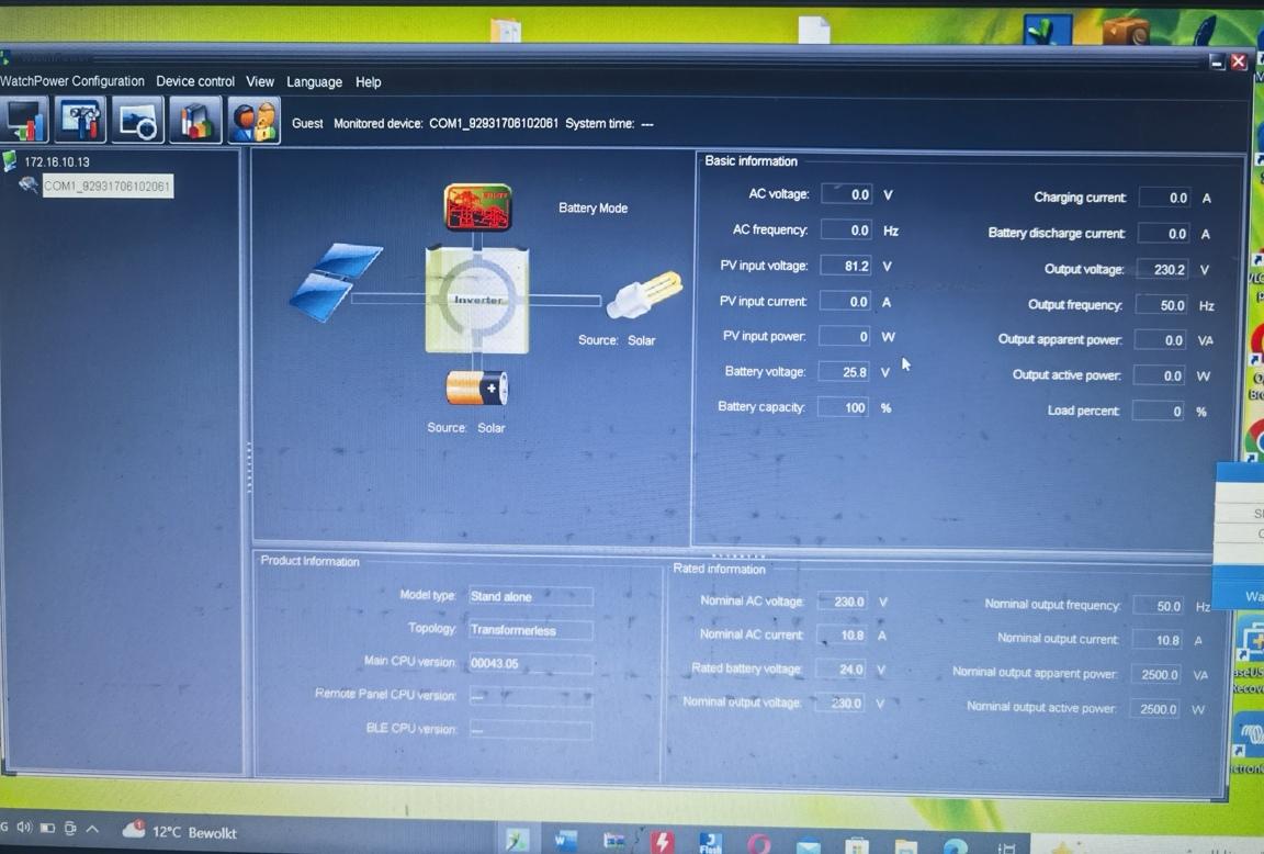

Because after I updated the firmware the Inverter changed capacity from 5kva to 2.5 kva and read battery as 24 volt instead of 48volt and run fan in 100% of speed and I tried to install another firmware but after update the Inverter does not work and only show the version of firmware on screen so I need firmware 20.43.... Or 20.44. to install it and fix the problem.
Or I need modified version of this software to read battery and capacity true and fix fan problem
IMG_20241103_145105.thumb.jpg.3e84ecec926a2d69e27e19727f4ca943.jpgBecause after I updated the firmware the Inverter changed capacity from 5kva to 2.5 kva and read battery as 24 volt instead of 48volt and run fan in 100% of speed and I tried to install another firmware but after update the Inverter does not work and only show the version of firmware on screen so I need firmware 20.43.... Or 20.44. to install it and fix the problem.

you are right
in your case fleshing the firmware could solve it
I was just researching two different firmwares, both 43.05, and they are both either 2500W 24V or 1200W 12V.
The VM firmware numbering is very confusing.
Were you able to download the 20.44 firmware from my link? It at least has the capability of driving a 5 kVA 48 V model.
