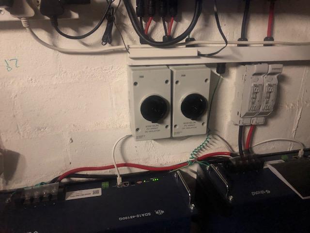

I have two of these in parallel. Yesterday at the end of the day they were fully charged (all SOC LEDs lit). This morning one of them has 2 SOC LEDs lit and the other is flashing RED in alarm mode which I believe indicates it is flat. Do I have to cascade them to get them to discharge evenly? Tx.
I have now had the batteries correctly wired up for 4 days and its better but one still drains considerably faster that the other. If I run things conservatively one battery will be showing 2 or 3 out of 4 state of charge LEDs on in the morning and the other one less. If I am more aggressive then one battery will be on 1 or 2 LEDs and the other flashing alarm. This is after both batteries ended the previous day fully charged.

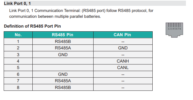

I believe the cable should be rs485, not lan. I just oredered a set of 3 similar looking batteries, from another manufacturer, and i am curious how they will perform. I am looking for people Who have similar batteries to share their experience.

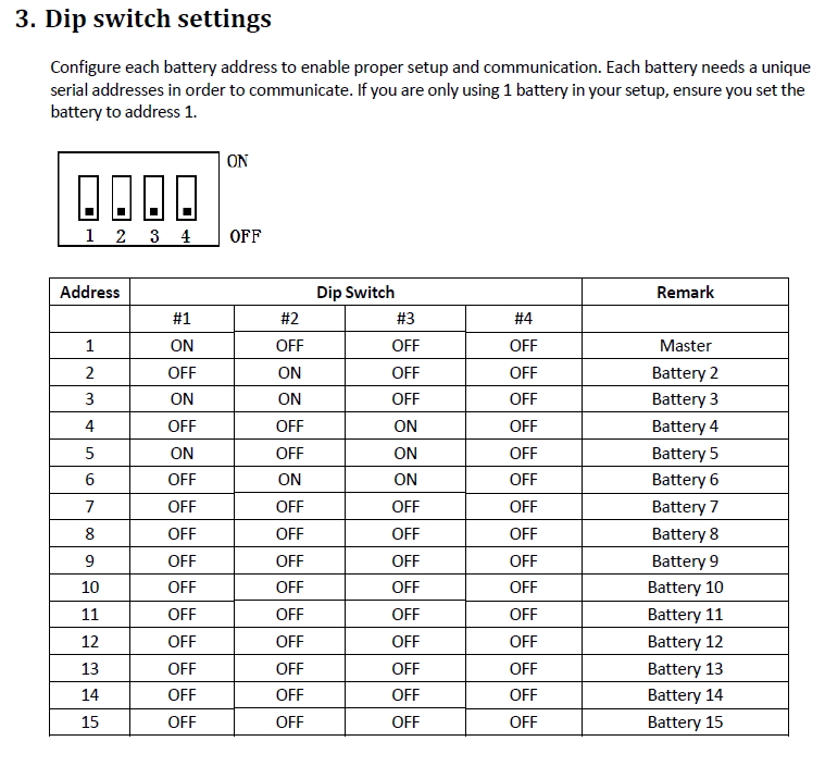

Yes I think I have the 15s version. I have an RS485 to USB cable for the connection to the Solar Assistant Raspberry Pi. As far as I am aware the cable between the batteries is simple straight LAN cable (no crossover) which is what I have.

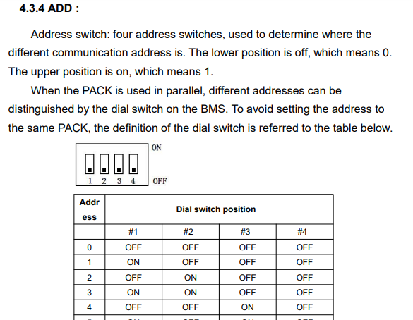

Maybe someone else with more knowledge will enlighten us. I suspect that a special cable is needed, as the ports should follow the rs485 protocol. Also, with different manuals of these batteries, i often saw that the master should be with the address 0000 (all switches in the 0 position), but again, nothing can be taken for granted.
If you get the chance to try cascading the with a rs485 wired cable, let us know how it went.
on the other hand, according to this, the straight lan cable should work...
