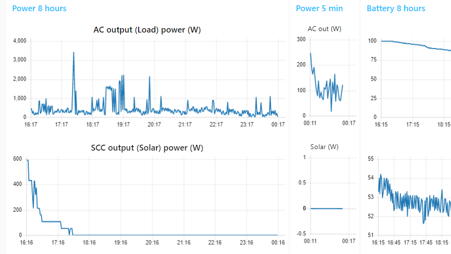

August 20, 20215 yr 17 hours ago, ebrsa said: Voltage switching levels are set to minimums on the Axperts so as not to interfere with ICC. As voltages are set on ICC, I guess there is not any benefit in reflashing the inverters with LF73.00e if I replace the Trojans with banks of 16 series connected LiFePO4 cells. No, as per the above, there are other subtle changes that make it worth getting the correct flavour of patched firmware (LF1 versus LC1). 17 hours ago, ebrsa said: Are you using any controller other than the Axperts on your own system Yes, I have a BeagleBone Black (similar to a Raspberry Pi, but not identical) with custom Node Red monitoring software written by a colleague. So I get graphs like the below (sorry, not that exciting since it's night time here): That's only half the graphs, and there are another 4 or so pages of dials, settings, a debug screen, a 5 dial overview, etc. All data is logged, so I can go back to data from any earlier day as a .csv file, though it's a slight pain to dig it out. The custom monitoring software talks to the custom BMS that we designed as well. We had grand ideas of selling it all, until we realised the hassle of supporting it all. All except the Node red stuff is open source and open hardware, for the extremely brave.
