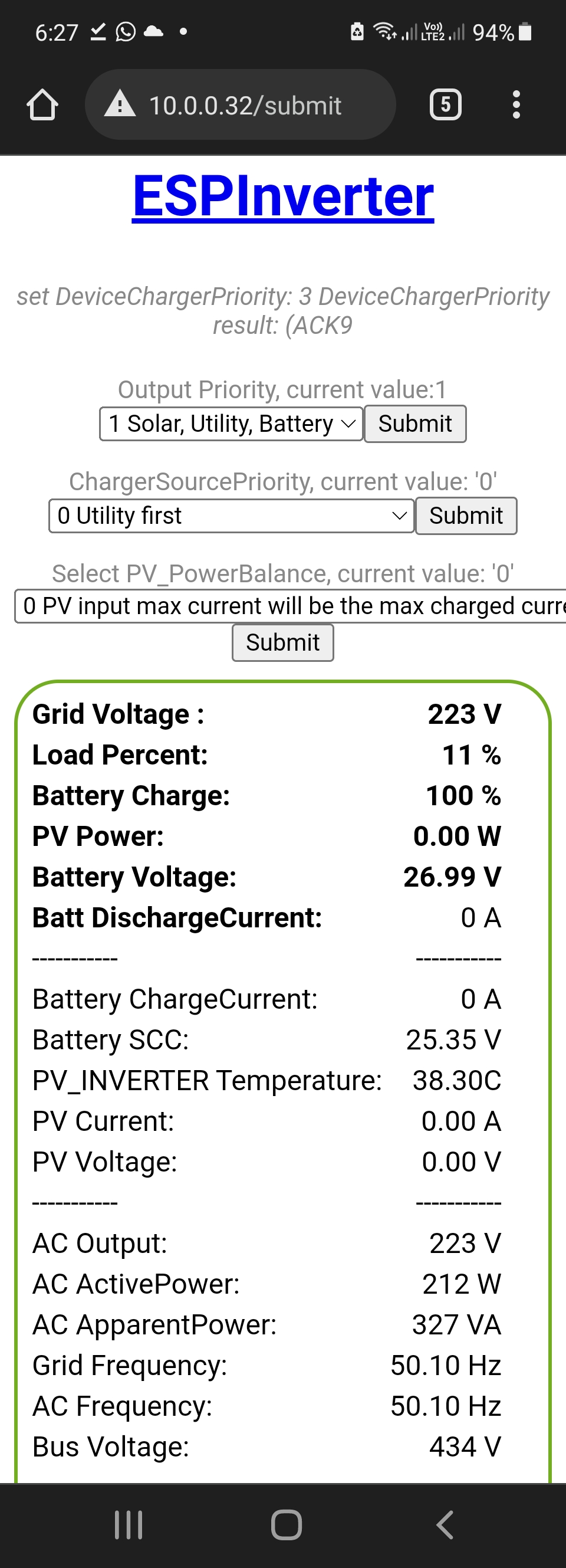

How's it going with this topic? I have developed some software for the Esp32 to manage my cheap generic hybrid inverter , would be interested in getting it to work on your board.
Do you have the max232 on board to convert the rs232 signals to TTL because wiring up the external max232 is a pain!
I also need  i2c headers with power for a small oled display I connect which shows the device ip address and some basic inverter info.
