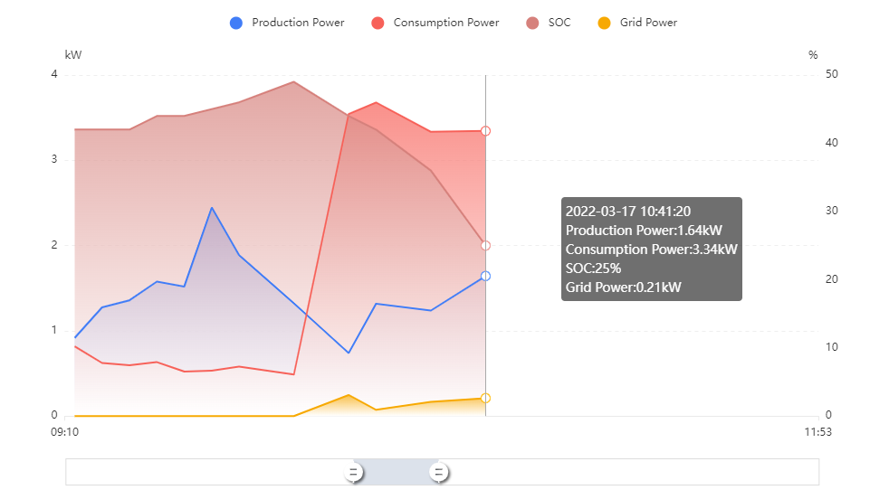

After this upgrade it seems like the inverter wants to use the grid sometimes even when the battery is charged, as an example if the house is drawing 3kw the grid might be supplying 500w or 900w, it seems to change but it definately supliments from the grid more now. Its annoying because if theres battery power I dont want it to use the grid at all until it reaches the specified % in the work mode settings to use grid, mines set at 15% at all times and these settings havnt changed, ive been through all of the settings and all of them are still the same as before.

An example below, even though its only using 200w from the grid instead of all on battery:
And a little later:
Edited by MakoShark
9 minutes ago, MakoShark said:
I small example below even though its only using 200w from the grid instead of all on battery:
iMy inverter is on the same version, and no i dont seem to have this issue.
actually is stable, drawing 20W from grid, as per setting
