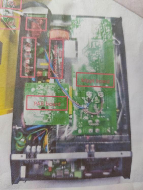

In the service manual it shows the par board to the left of the mppt board. Is that board usually known by another name
OK, that's what I think of as the SCR board; PAR sounds too much like the "paralleling" board.
Not much is known about this PAR board; I believe it somehow brings down the changeover time from 20 ms to 10 ms by paralleling the relay contacts with SCRs, or something like that.

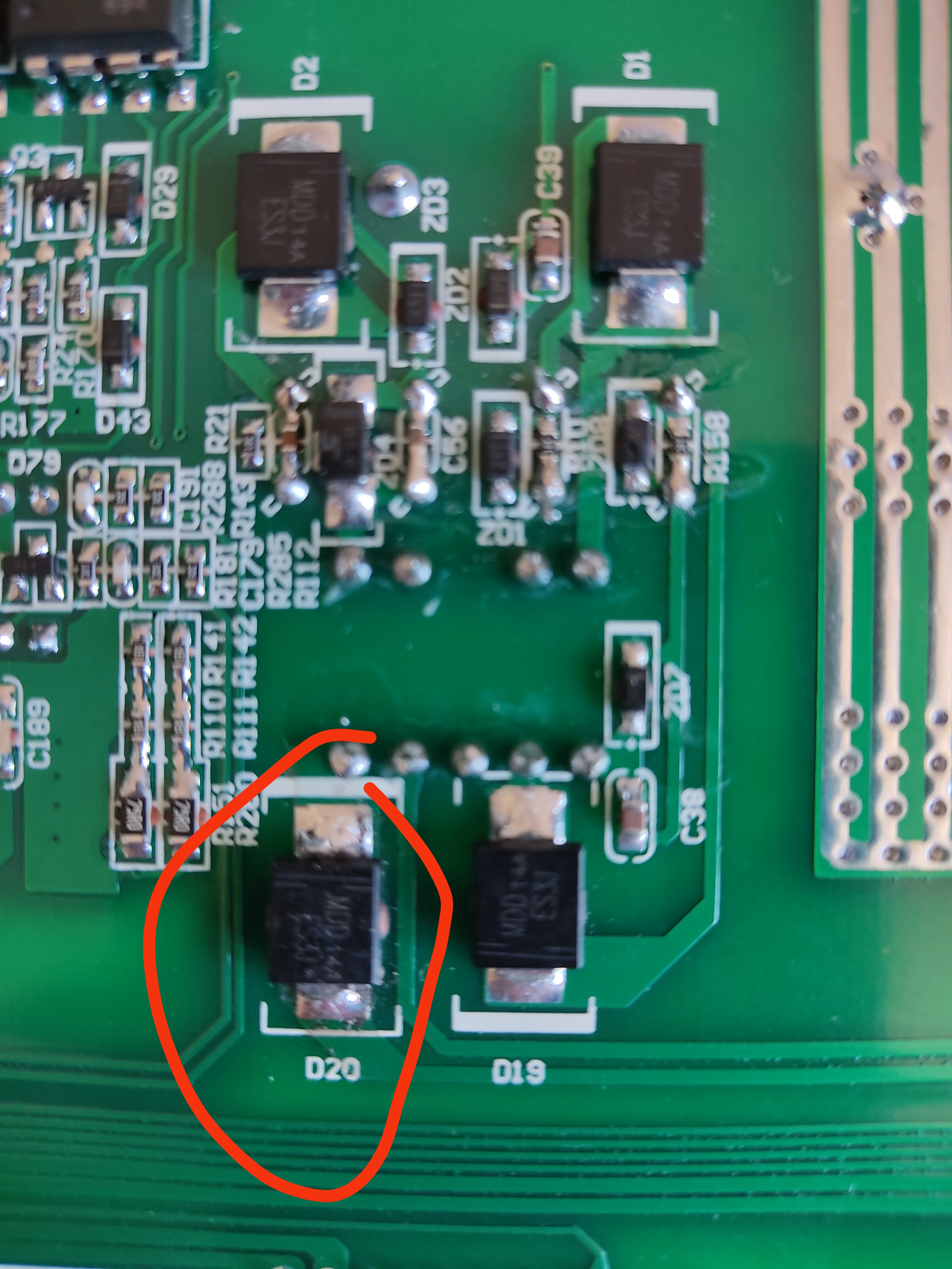

Looking at the IGBT circuit again the emitter short is ok, it connects to the negative side of the DC which is correct . The only other anomaly is D20 is short circuit, I removed the diode to test it and the diode is ok, anyone know what D20 does?
On my old model, D20 is one of four through-hole 1N4007 1 A diodes. But that's for the 230 VAC power supply, which recent models don't have.
Can you describe it or post a photo?

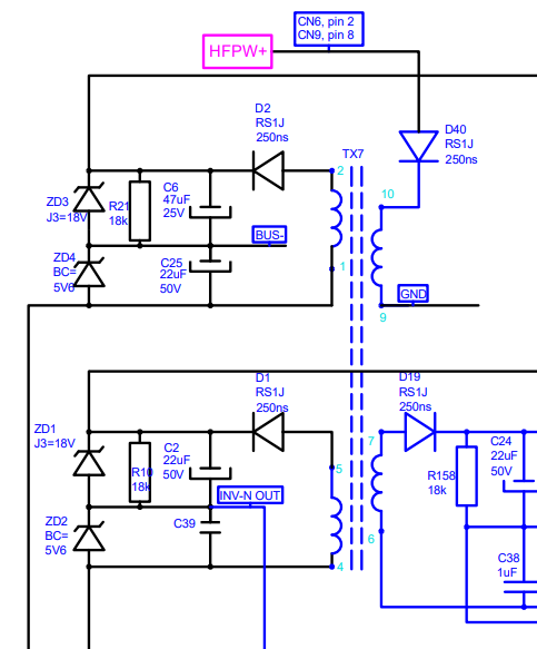

Ah. I'd say that's D40 on this schematic:
HFPW+ (High Frequency PoWer +) is a square(ish) wave power connection from the main power supply. Rectifying and filtering it produces +12 V. The main power supply is a flyback design; these are intended to provide power in only one "stroke". The "intake stroke" ("induction stroke"?) fluxes the multi-winding inductor; during the "power stroke", the inductor de-fluxes and pushes current into the loads. D20/D40 is intended to ensure that power only flows during that "power stroke".
TX7 provides isolated power for the IGBT drivers: the two high-side full-bridge IGBTs, and the third drives the three BUS- referenced transistors: two low-side full-bridge transistors, and the buck transistor. Each winding provides ≈+15 V and -5.6 V for the gate driver output side.
Thanks Coulomb for the explanation and diagram, looking at this diagram and the hfpw diagram it looks like one side of D20 goes to ground through the windings of TX7 and the other side of the diode goes to ground through the windings of TX9 so it makes D20 look like it's short circuit but in actual fact I was measuring the very low resistance of the windings.

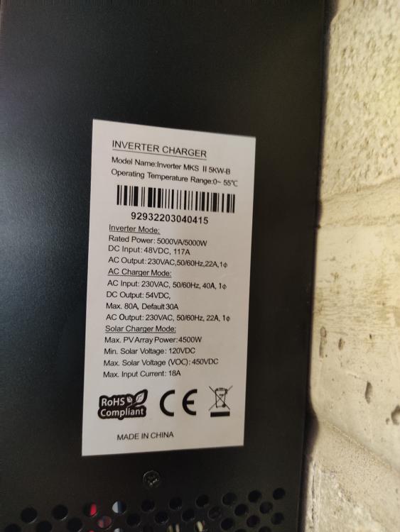

Out of interest with my diode being numbered D20 instead of D40 could that my inverter could be a clone?
That by itself, no. See Do I Own a Clone? for clone checking.
Edit: most newer models don't have the AC-in power supply, so they would not have D20 and its neighbours. So re-using designator D20 seems pretty reasonable. Sadly, no-one seems to have traced and published a schematic for any of the later models.
After reading the above post everything appears ok except that it doesn't have the little date label.
Also I've Just noticed it doesn't actually have Axpert in the model name.
Does this sound like it could be a fake inverter.
That's actually pretty telling, though of course they may have changed their manufacturing habits.
The label also seems too far from the front panel.
I don't believe that's necessary or significant.
There is something about the label that says to me that it's not quite right. In particular, the font and the height of the barcode, and spacing of the bars.
Also, I have this theory, NOT confirmed, that there are no genuine Axpert MKS IIs or VM IIs made for the last several years; all the genuine models* have at least a removable display, if not the even newer round colour display. The above label suggests a manufacturing date of 2022/March, which according to this theory is way too recent. If anyone has evidence to the contrary, I'd love to hear about it. So that unconfirmed theory suggests that it's fake.
* Edit: now that I think about it, I do believe that there are still some Axpert MKS models made, being those with the 145 V max PV voltage. These would still have the oldest non-removable monochrome displays, so I guess it's not a big  stretch to imagine that they also still make the Axpert MKS II, which seems to be considered part of the Axpert MKS I family, if you like. It appears with the other Axpert MKS I models on the Voltronic Power web page (see the Specifications tab).

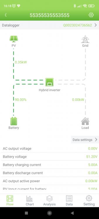

I managed to repair this unit by changing the two faulty IGBT's, it's now working ok and I have just connected via WiFi, the unit ID is 5535553..., Which I think I've read before is another pointer to a fake unit, is that correct.
Yes. It's been known that genuine Axperts have had this number; it can happen if the EEPROM loses its values, for example. But generally, it's another strong indication that this is a clone.
Thanks for this part of the diagram. Do you have the complete schematic. My inverter had the ZD4 open, it seems that the one of the ceramic capacitors in parallel with the electrolitic capacitor was shorted. Any way it is working now, but I would like to have the complete schematic. In the service manual does not appear.
The schematic is an unofficial thing, with most of the hard work done by forum reader Maxo. They don't want to give the clone makers too much help, even though the clone makers seem to have access to the schematic, or they just trace it themselves.
