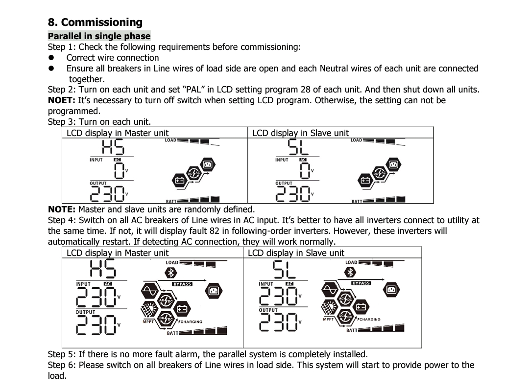

July 1, 20224 yr 14 hours ago, AndrewM314 said: Power back on sequence, switched battery mcbs on, switched solar isolater on, turned master inverter on at switch, turned slave inverter on at switch at which point there was a pop and the battery mcb tripped, now the slave just trips the battery mcb instantaneously. The paralleling instructions call for turning the two units on simultaneously. It mentions that the selection of master and slave is done by themselves arbitrarily. I found out that the unit that is turned on arbitrarily first becomes the master. So I turn the one I want to be the master just a fraction of second on before the slave. When I do this operation I have the AC and load as well as PVs switched off and turn them on afterwards. If synchronization fails as you describes, there might be a faulty paralleling board.
July 2, 20224 yr One very important aspect to add to what @Beathas added. When you parallel & have each output onto its own breaker that then feeds into a larger 63A breaker. DO NOT disconnect an individual output breaker under load. What you will do is overload a single unit depending on the load. In other words, disconnect the large breaker 1st before disconnecting the smaller individual breakers. Do the same on start up in reverse. But @Beathas the startup sequence perfect.
July 2, 20224 yr Author Many thanks for the responses, As suggested I'm going to add circuit breakers to each AC output. I can't seem to find an official start up sequence in my manuals, all it refers to in my parallel manual is that the AC input breakers should be switched on simultaneously which doesn't apply in my case as I have no AC input. Does anyone know the official power on sequence from totally switched off.
July 2, 20224 yr The, startup sequence for you would be battery power start first. So DC battery breakers on 1st. Then both inverters on together on the button push. Once the inverters have stabilised & HS & SL are chosen, I would turn on the PV 3rd. Only after both have sensed the Voltage on the PV. Lastly I would close the AC output breakers both together & then the master AC output breaker. 1) Battery DC on 2) Inverters On together 3) PV DC breakers or isolators On 4) Each inverter AC output together 5) Master AC output
July 3, 20224 yr Before turning on either output breaker, I would measure output live to output live, and don't turn on unless the voltage is under 10 VAC. For extra points, test for several minutes to make sure you didn't fluke synchronisation, they might drift out of synchronisation with time.
July 3, 20224 yr 12 hours ago, Coulomb said: Before turning on either output breaker, I would measure output live to output live, and don't turn on unless the voltage is under 10 VAC. For extra points, test for several minutes to make sure you didn't fluke synchronisation, they might drift out of synchronisation with time. Great post to ensure the tech in each inverter is actually working. Too expensive to work with trail and error around synching.
