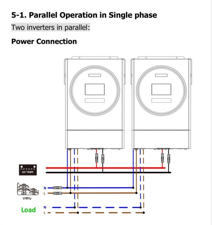

July 31, 20224 yr Hi all Since this is a cross technology battery and inverter question I thought I'd place it in this section, hope that's right? So I have a parallel pair of 5KW Voltacon branded Axpert King inverters. Each have their own solar array, both feed a common stackof pylintech us2000 batteries and one has bms control of the stack. I have observed I can pull data between them in Watchpower, but that is as far as the 'parallel' function appears to go. The two inverter control panels are totally independent, I can set completely different settings on each and those settings are applied individually. Further the 2nd inverter doesn't realise it is bms connected to the batteries and must be put into 'user' battery mode so as not to go into fault. This causes the pair to not work very well together and to declare the batteries full/empty at differing times. Is this normal? Secondly, I have just bought some of the new voltacon branded 100Ah batteries, which they assure me are not compatible with the stack function of pylontech's own models (I believe this to be false information) despite being identical to the new pylontech 100Ah unit. Is there any reason, why I can't have two separate battery stacks for the two inverters (since the inverters appear to be so independent anyway), each with bms control from it's respective inverter? New voltacon batteries here https://voltaconsolar.com/lithium-battery-100ah-5120wh-48v.html Many thanks Swen

August 1, 20224 yr 16 hours ago, swenk said: Hence my question about a 2nd battery stack... One per inverter, bms both individually bms connected. Oops, I missed that question. The manuals certainly say that the battery has to be common between all of them. I believe that's because the master figures out what current to charge at and so on, and the slaves just copy that behaviour, not figure out to to based on their own battery. So: I certainly would not have separate batteries.
August 1, 20224 yr Author Hi Thanks both for confirming. Yes I appreciate the diagram in the manual, it wasn't clear whether is was 'suggested' or mandatory. Thanks, I am now updating the firmware to see if I can improve the parallel functionality, to try to stop the 2nd inverter going into bypass when the batteries go below 50%. The master inverter is performing perfectly. I'll post back any additional info I learn.
