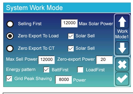

The magic trick is to make sure the CT coil is pointed the correct way ( must point towards the Inverter on the L1, L2, L3) & the export must be set to zero Export & 20W set. This will prevent all these issues.
The main reason is that there are ppl that actually do meter tamper & of course it's the council looking after their property.
Here is the page that helps to get the settings correct. Export must be set to zero. Sell power must be unticked. This is just the menu setting for illustrative purposes.
