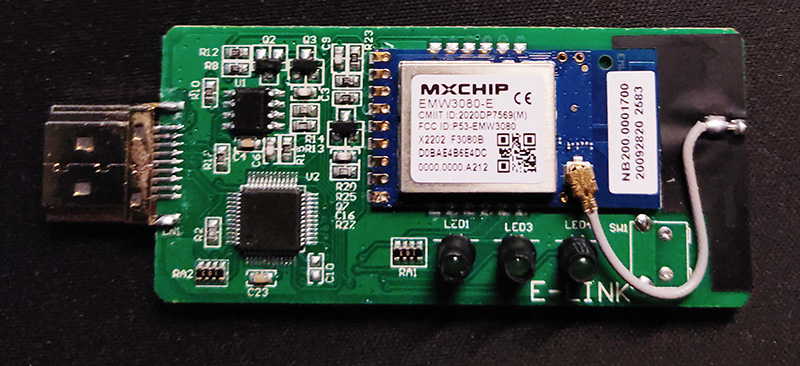

Issue Description:
Wifi dongle does not connect to local network anymore and does not start it's own network (BA*******).
Wifi LED is constantly on. Cloud LED constantly blinking. All ways to connect to it are failing.
Solution: Reset the dongle's WIFI chip (MXCHIP EMW3080)
Optional Remove bottom black front cable protector fro inverter to get better access
Step 1:
Remove the dongle from inverter, remove rubber layer from the dongle, unscrew the screws and take out the electronics board from the plastic casing.
Step 2:
Insert the electronics board in the HDMI slot of the inverter and wait a few seconds
Step 3:

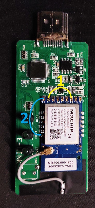

Reset the board by bridging PIN 16 and PIN 11 with small wire. Hold the wire in place for a few seconds.
( I noticed that the wifi light when off briefly when this was done?)
Then remove the wire and un-plug the dongle board. (flexable wire works best due to the awkwardness of access)
Step 4:
Plug the electronics board back into the inverter.
Bridge PIN 17 and PIN 23 with a small wire. Hold the wire in place until the WIFI LED starts blinking rapidly.
Remove the wire.
LEAVE IN INVERTOR NO NEED TO REMOVE FROM NOW ON
The device will continue blinking the LED, then stops after some minutes, and resumes normal working state (WIFI LED is constantly on now).
At this stage the dongle's own wifi should be available to connect. Instead of BA****** the name is now MXCHIP_****** but the setup process is the same.
Connect to the MXCHIP_**** network. When connected, open a browser and go to http://10.10.10.1.
The normal MiCO set up page should come up with default credentials (user: admin, pass: admin)
NOTE: It took me quite a few attempt to get it to reset
Once complete place back into original case

Just came here to say thank you very much for this. I'm not sure if step 3 was necessary because I reset it twice but the 2nd time, I jumped at step 4.
But anyway, I changed AP's password before and I forgot it. So I was finding ways to reset it then I found this.
