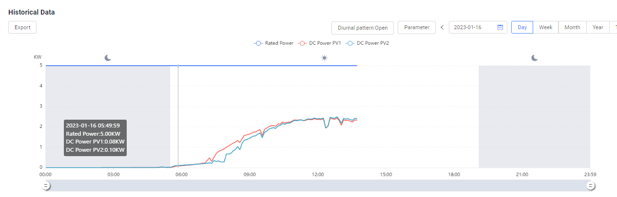

  • I have also noticed that my production seems to mimic my consumption from noon onwards ( see graph below ). I recall reading somewhere that the panels will reduce production based on the load required. If so where can I configure it to not do that?

4.5 kw peak seems about right, esp with that string orientation. The heat (if you are in GP) will also cause some efficiency loss. The PV throttling down to meet demand is a feature not a bug - the only way you can change this is to have more load at those times OR export that excess PV either to the grid or to non-essential items. I am guessing that your batteries are topped up and 100% by 12pm?
On solarman you cant view the DC split on the main screen / graph. Navigate to Device > Inverter>Statistics. Select your time frame then click the graph and select Parameter Selection. Select DC Power for MPPT 1 and 2 and it should give you the required view. This is on mobile app and Solarman Home. On the web once you get to Device then scroll all the way down and you';ll find the same graph that you can then change
I would need to confirm but yes I think you are right that by 12 the batteries are fully charged therefore there is no where else for the excess energy being produced to go. Cant really afford to add a 3rd battery at this stage.
Thank you for the Solarman Info, exactly what I was looking for
So based on what I am seeing is the drop at noon is like said likely due to reduction in load so reduction in power and not so much position of sun in relation to the different string sets as they appear to be pretty much working in sync

So I tried as suggested to shift my load around, still need to tweak it but already see a bit of an improvement
The noon dip is not as drastic and not for as long
