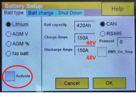

If you have a SunSynk, there is an "Activate" option specifically to activate the BMS of a run down battery.
The Charge/Discharge are for my 4 x AM2 system, reduce as appropriate.
