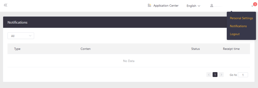

I'm encountering a (admittedly minor) bug since this update, whereby the red 'notification' counter/badge now shows a figure (it's 3 at present but yesterday it was 2) - but when reviewing the Notifications, the list is empty (so it shouldn't display the badge):
Any ideas? I leave the web portal open all day long on my spare monitor so this is triggering my OCD; this doesn't affect the app.
(Wouldn't be a true Sunsynk release without at least one bug, right?)
Still, I'm really enjoying the new notification since it allows me to remotely change my consumption profile (by turning off smart plugs remotely) to save battery in case of an extended outage, if the grid doesn't get restored when expected - without having to go all the way into the app to check that it's back. Very nice.
This is fixed! As of this morning the notifications now appear in the list - and I can clear the badge with one click using the 'Read All' button.
