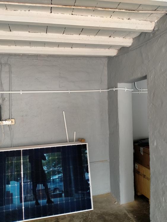

So some phase work to get all the essentials onto a single phase. Then leave some Non-essentials on the Grid side splits amongst the 3 phases.
A combination of a flat concrete roof & some corrugated sheet.
So we embarked on the journey of the Kodak OG10, FreedomWon 10/8 & 10 x LONGi 480w Monos. Unfortunately with supply chain the way it is, this project will be spaced out & done in a few stages.
Mounts only available on the Corrugated roof. Ballast weight block system will follow but is not in stock at the moment.
Will be heading to Durbs next week & this Install will continue once we get back & stock is no longer an issue. Bear with me because  I will show steps & bits & pieces.

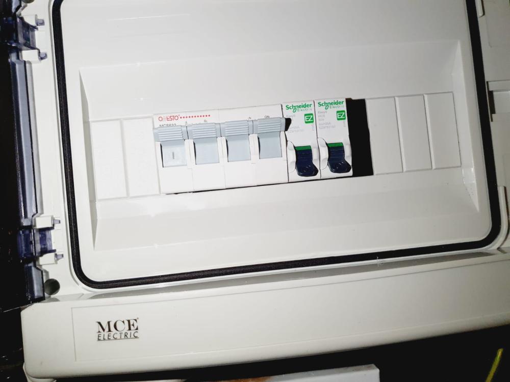

The Main DB is in the main house & the garage is the chosen place of installation. That distance is a rolling 25m by distance. 10mm2 AC cable used that matches the +-50A AC in & out.
A lot more to follow in the coming weeks. I will also share some installation projects in Durbs as I know that these projects fit many forum members requirements.
The main issue we face as installers is that mostly older homes the wiring is old & to they use Heinemann switch gear & they are no longer sold so you faced with either Samite or Din & then you have to go with what is already there. However, note these are not final pics. The final pics will promise a lot more. I have found that just taking final pics doesn't really help anyone learn anything. I can share final shots & nothing would be gained. However, delivering the process breaks down the learning curve.
