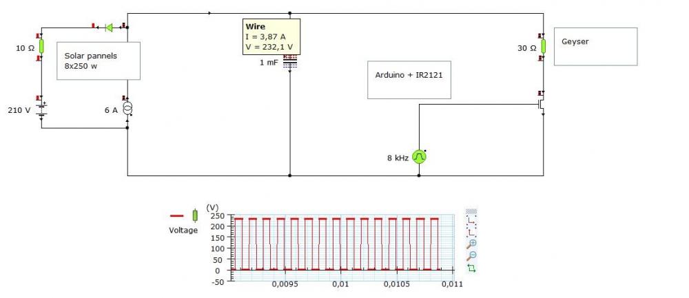

I think it is a good price, but if you are used to "electronics", it is possible a DIY. I did some months ago, round 100 €, R1600 ?

Do you have any link/info to your DIY version? Not that I'm likely to build one DIY myself for the insurance reasons mentioned (and general anti-DIY climate in the country), but I am always interested to learn new things (all these systems seem to do things slightly differently and its interesting to see) so would love to know the details.
This is the mainly scheme:
It is needed a goog capacitor, 1 mF 400 Vdc and a ripple current higher than 10 Amps. Also is needed an IGBT or Mosfet with Vds or Vce higher than 400 Vdc.
MCU can be an Arduino, measuring current and voltage and triggering IR2121, which switch ON/OFF the gate of Mosfet or IGBT.
Good day Javi,
Do you have more info regarding the circuit and the arduino used and the arduino sketch please?
Rooies
Any model arduino should work. It would be interesting to see the sketch. Also which sensors you are using to measure voltage and current.
