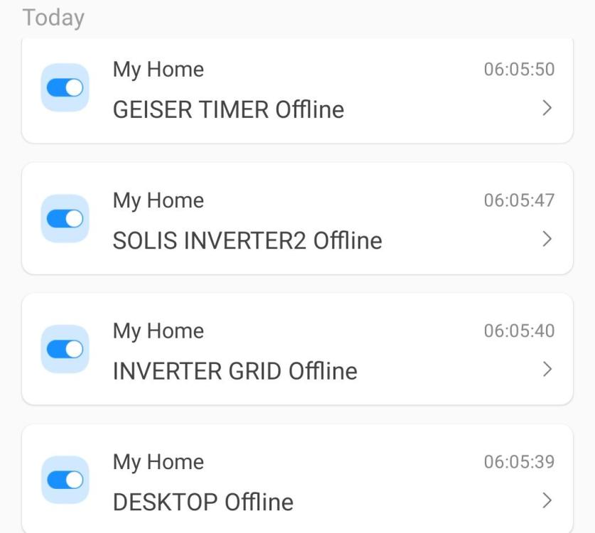

April 26, 20233 yr 1 hour ago, Snapper said: Thanks, I've seen those but I couldn't figure out whether they work at all when the Internet connection is down? The reviews imply that an internet connection is required, which would be a concern for me. I need a robust solution. 😐 The unit cannot get to the APP if it has no power or it has lost contact due to no Internet. Both these conditions will send a notify to the cell as per below. This is for Sonoff via Ewelink. You don't need a special contactor. You can use the Sonoff to drive any contactor coil and that can do the switching. As far as your question. If no Internet to the Sonoff the it cannot operate to alert you or allow you to control it or change timer settings etc. That's why you get the alert of off line status. Exame of notify with LS this morning. Edited April 26, 20233 yr by Scorp007
April 26, 20233 yr Author 3 minutes ago, Scorp007 said: The unit cannot get to the APP if it has no power or it has lost contact due to no Internet. Both these conditions will send a notify to the cell as per below. This is for Sonoff via Ewelink. Exame of notify with LS this morning. Ok I see. So one can presumably script or configure a shutdown event from that notification? I’m not sure that would work for my needs though - I need non-essential loads killed instantly if grid goes down, or else the excess draw could trip my inverter. 🫤
April 26, 20233 yr 5 minutes ago, Snapper said: Ok I see. So one can presumably script or configure a shutdown event from that notification? I’m not sure that would work for my needs though - I need non-essential loads killed instantly if grid goes down, or else the excess draw could trip my inverter. OK I see it now. You will need a power point not on the inverter That power point can be the input to the inverter as that goes off when grid is off. Edited April 26, 20233 yr by Scorp007
