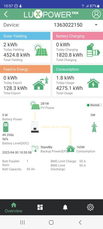

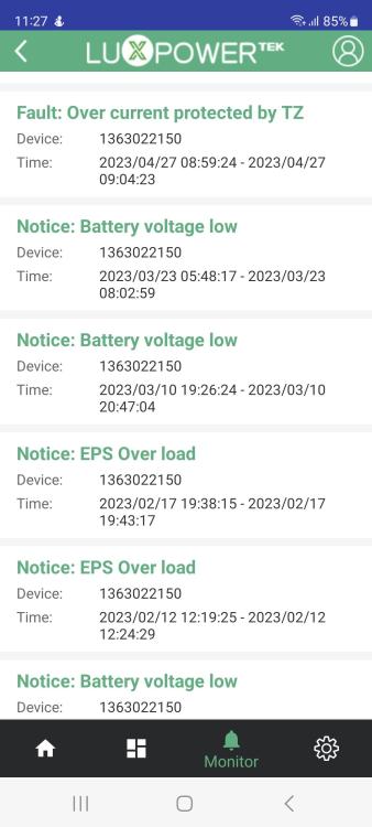

I have my solar system (Luxpower SNA5000 inverter and Dyness 48100) installed since December 2021. A couple of days ago I received a message on my inverter Över current protected by TZ". Since then the battery is not charging or discharging at all. It is stuck on 55%. The inverter is still working.
The inverter still recognize the battery. See screenshots below.
Do anyone have this experience this in the past and how do I get this resolved?

Could it be that you had a higher load than you usually do running on the inverter? The dyness is a 0.5C battery which means you are limited to 50A draw (as show in your 2nd image) and your inverter is capable of 5000W@50V=100A (simplified), so it is possible for the inverter to overload the battery if you only have 1 module.
You might need to reset the battery to get it out of the protected state. I would turn off the inverter loads, turn off the panels, disconnect the battery and switch it off and on again and then reconnect. Not sure if the dyness has an on/off switch or if you'll have to hold in a reset button until it turns off.
You should set your inverter to 50A discharge limit if possible to avoid this in future.
