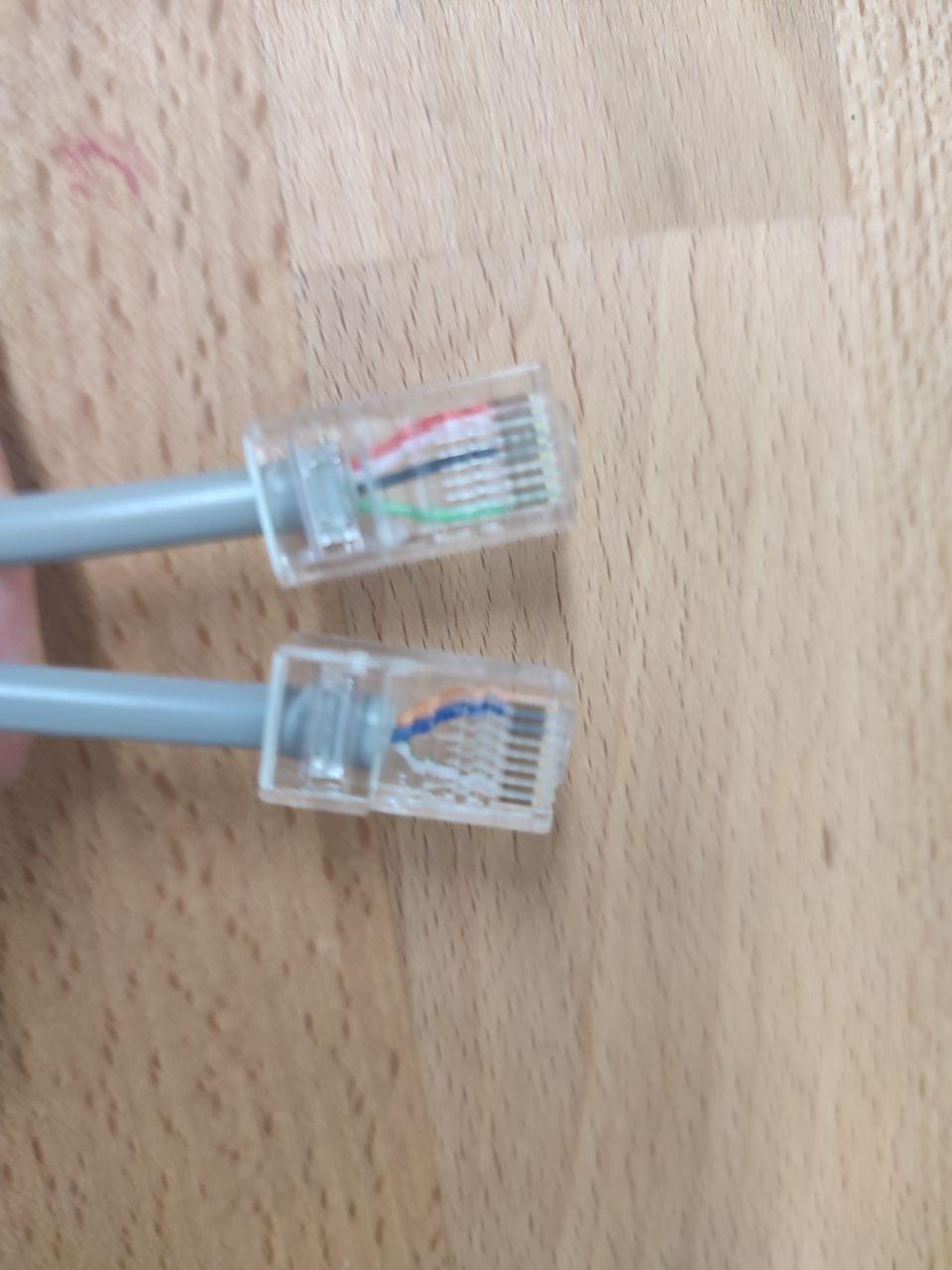

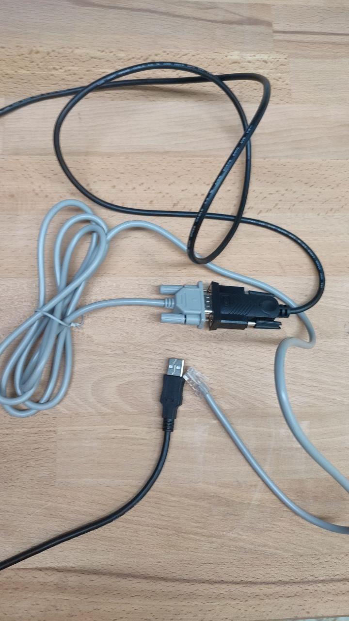

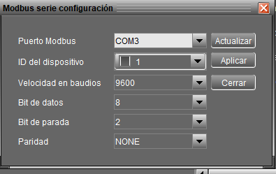

Hello Coulumb, I hope you are well, I have a problem with the update, let's see if you can help me.
I try to connect the inverter to the PC with the UTP/RS232 cable, I have bought an RS232 to USB transformer, the PC recognizes the transformer but I cannot connect the inverter with the watch power program.
If I connect the inverter with the mini USB cable it does connect me with the watch power program, but I understand that the screen can only be updated with the UTP/RS232 cable.
Another question I have is that there are two types of UTP/RS232 cable, one with 3 cables (pin 1,2,8) and another with 4 cables (pin 1,2,4,8) where pin 4 is power.
I have tried the 3-wire one and I cannot connect two of the same inverters that I have tried.
Where do you think the problem must be?
Could there be a problem with the baud? Both the program and the USB input are configured at 19200.
I attach a link to the rs232/usb cable that I purchased.
https://www.amazon.es/dp/B0753HBT12?ref=ppx_yo2ov_dt_b_fed_asin_title&th=1
Thanks for the help
Edited by AlfredCE
That's a good sign; it means that the display isn't bricked. Is this using a type A to micro-USB cable direct to the PC?
Is that the cable that came with the inverter, RJ-45 at one end, and D9 (RS-232) at the other? And are you plugging the two cables together?
It should be display -> cable that came with inverter -> USB to RS-232 adapter -> USB port of Windows computer.
That should be able to run Watchpower.
It's possible that the USB to RS-232 adapter isn't one that the Voltronic software works with. Check for a COM port appearing in the Windows Device Manager, and that the COM port is COM1 through COM9. I don't know about the display update tool, but early Axpert reflash tools would not work with COM10 or higher.
No, the reflash tools set the baud rate automatically. It actually starts at 2400 bps, and changes to 9600 bps as the reflash actually starts. I have no idea why they put a baud rate drop-down box there.
That looks OK, but as usual it doesn't say what the chipset is. The AEVA pages have suggested bands, and known good brands available from South Africa, but I don't know where you're from, and what may be available.
When trying to reflash, I assume that you're following the upload instructions, and are getting the UPG YES on the display? But you probably need to get it working with Watchpower via RS-232 first.
I also assume that you're plugging the cable that came with the inverter into the port nearest the PC/monitor icon.

When I connect the cable, Windows recognizes it with com 5, but I can't get it to connect with watch power. I tried to update the inverter screen but it tells me that there is no connection to the inverter.
The problem is that I don't know which cable came with the utp/rs232 inverter, I mixed it with others and then I realized that there are some with 3 cables and others with 4. I attach photos
If it could be updated with the USB cable to the PC directly, there is no problem because it recognizes it well, but it cannot be done with the UTP cable. Do you have any idea what it could be?
17 hours ago, AlfredCE said:
4. I attach photos
Those both look ok, but perhaps check the connections anyway. The connection to pin 4 or 7 doesn't matter as it's not used in this application; you need the connections to pins 1,2 and 8 as per this post:
https://forums.aeva.asn.au/viewtopic.php?p=57914#p57914
It could be that you have the wrong driver for the PL2032 chip and your version of Windows. Google it.
You can check the wiring by shorting pins 2 and 3 (tx to rx) on the D9 connector, and using a comms program connected to COM5. Everything that you type should be echoed back to you. With local echo turned on, you should see double echoes (e.g. type h, see two h characters).
I have already been able to connect the inverter with the PC, I send a photo of the modbus configuration. Now I need to try updating.
But still only via USB, not RS-232? The update tool only talks RS-232.
I note that Modbus is RS-485, not RS-232. You also have to make sure that nothing else is using COM3.
Hace 2 horas, Coulomb dijo:
¿Pero todavía sólo a través de USB, no RS-232? La herramienta de actualización solo habla RS-232.
Observo que Modbus es RS-485, no RS-232. También debe asegurarse de que nada más esté usando COM3.
Yes, in the end I was able to connect with the rj45/rs232 cable, with the cable that I bought on Amazon it works perfectly. With com port 3, changing the stop bit to 2, and the baud to 9600, the connection between inverter and PC worked. Now we need to test the update.

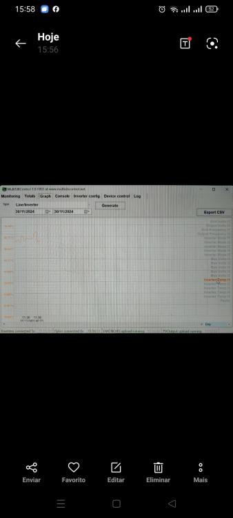

Did it worked? I have got the SAME IDENTICAL PROBLEM with U1 61.01 AND U2 22.20
