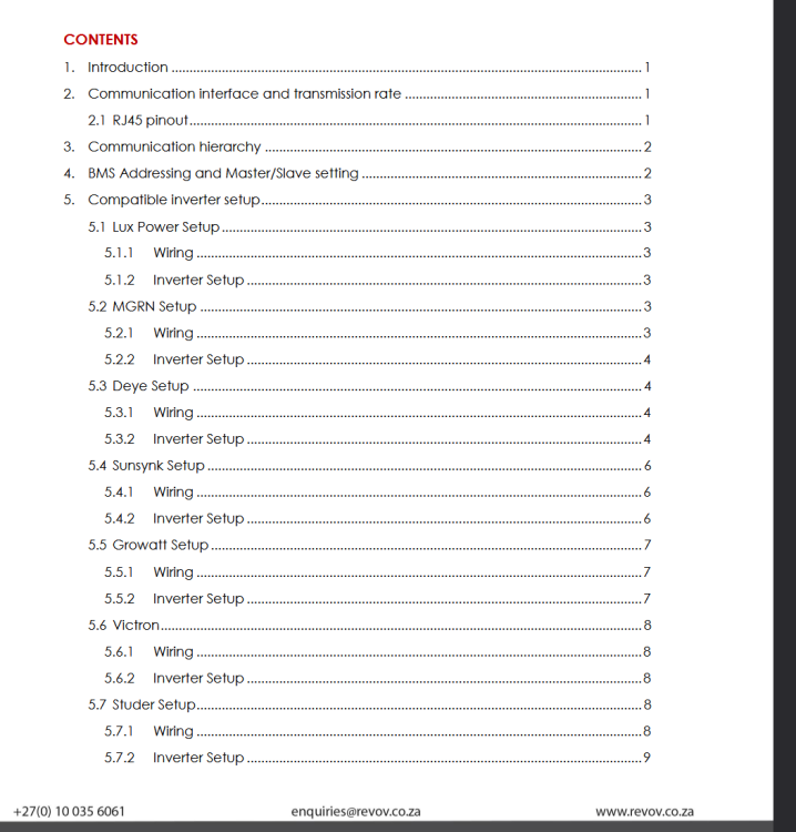

Might be the the older version before the R100
https://www.geewiz.co.za/index.php?controller=attachment&id_attachment=2523
