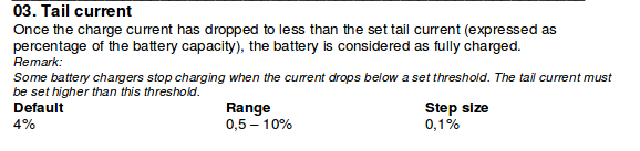

Hang on, I see where you went wrong. You're messing with this setting:
That's the wrong one. Leave that one at 0.1A. It's there only to filter out spurious readings at the low end. To put that into perspective, at 100mA the shunt is measuring a 5 Nanovolt signal (it's a 50mV 1000A shunt), which is likely approaching the point where it can no longer measure it: So this setting is there so that you can even tune out the noise at the low end.
What you want to set is this one:
It's already a percentage value. Set it to 1% and be done.
Edited by plonkster
Ha Ha seems like a case of lost in translation and not sure who went wrong :D
The tail current I had already set at 1% when you first recommended it, was always after what to set the current threshold as that was one setting you hadn't elaborated on! Anyways no worries will keep it as it is. (had fun yesterday trying to figure out why it wouldn't go above 2A till i read the parameters in the manual that you have posted above). Thanks for the explanation on what this setting does! Oh and it's a 500A shunt with the BMV-712 not a 1000A.
Thanks again chaps and have a good weekend!
