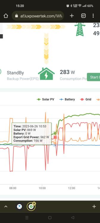

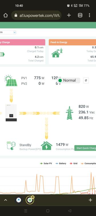

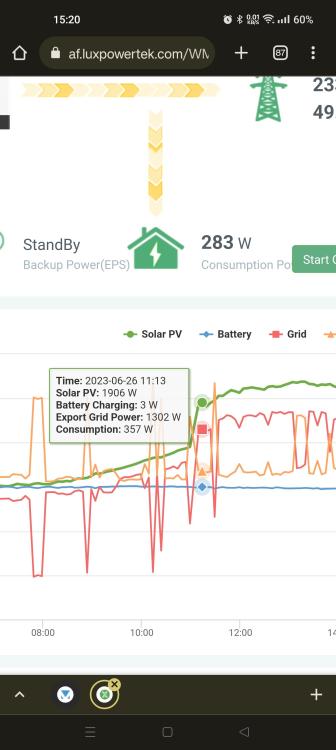

This morning I went to check voltage. It's starts every morning on 120v. I used the tester and it's 120v. As I pull fuses it go up to 291. When I re-engage fuses it starts at 291V and with in 1min it's steady on 238V. It stay at this till sun drops and steadily drops .Screenshot_2023-06-26-10-40-25-29_40deb401b9ffe8e1df2f1cc5ba480b12.thumb.jpg.54ef0fe1bbbbb31604fd85dd0b533a14.jpg
The fact that your inverter and tester both show the lower voltage points to it not being an issue with the inverter.
I'd say check for a loose connection somewhere, the fact the fuses seem to cause it to go up in voltage makes me suspect that may be a good area to start checking for something loose.
There is also the possibility of shading in the morning / not enough sun for high voltage and perhaps it is just a coincidence that after putting the fuse back in the voltage goes up - however once I could understand, if it consistently happens then that does not make sense either.

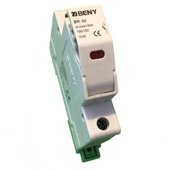

I have no shade problem and I think it might be a connection problem. heat and cold explanation on connectors maybe? it only started this last week sometime when we got minus temperatures. ill open all connection the weekend and put in a compound for better connection and with the main fuse holder(I believe MY ACDC fuse holders installed are not the best). If this still persist ill have to check each panel fuse as last resort.
Feel the outer case of the fuses if they are becoming hot you might have higher resistance on the fuse holders i have found at 10 amps some fuse holders become hotter than others a indication of low quality fuse holders. I agree ACDC definitely not good quality.
