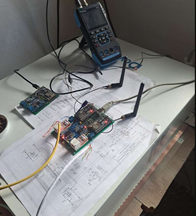

Hi ZS1SCI! I am using Deye SE G-5.3 battery. I am monitoring the battery using Canalist-II adapter and LVESS_Monitor V 1.18 program. I am also trying to monitor the battery via Home Assistant. Home Assistant receives data from Inter CAN port. I compiled YAML file to receive data from Inter CAN port about cell voltages and data about SOC, SOH, U, I Pack 1 PCS CAN port. But in Home Assistant only data about cell voltages from Inter CAN port appears. I checked signals on RX input (GPIO 16) with oscilloscope. Information from PCS CAN bus comes constantly. But why is it not displayed in Home Assistant then?
Edited by ppwwdd
Ohan, I forgot to say... Thank you for the information you provide on the forum. Your research helped me a lot. I have a Deye SE G-5.3 battery Hardware Version LVESS02_V 1, Software Version LVESS0223901 N01. This is probably an old version. My USB-CAN Analyzer V 1.8 read data from both ports in the CAN-Monitor-3000 and USB-CAN (V7.20) programs. The IDs from both ports match exactly what you got from your batteries.

I finally got the battery monitoring working in Home Assistant. I used two ESP 32 to collect data. One runs on the Inter CAN bus, and the other on the PCS CAN bus.
Edited by ppwwdd
Hi ZS1SCI! Thank you for the information provided on the forum. Currently I am monitoring my battery using Canalyst - II, Home Assistant via Inter CAN bus and PCS CAN bus, I also connected a NEEY balancer. Everything works fine. All that remains is to install Grafana. Thanks.Screenshot_32.png
