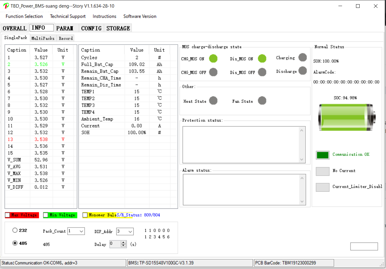

July 10, 20233 yr Author I've contacted the importers of the Shoto batteries to assist, as the application is not connecting to the batteries via RS232 or RS485. I know the cables are working, as the ICM Software connects to the batteries. We have 4 x SDA10-48100-L5 and 1 x SDA10-48100, which have 6 dip switches and not 8 dip switches like all the documentation keeps mentioning and they don't have a CAN Port.
July 11, 20233 yr Author The guys from Tag SA have helped me a lot today. 4 of my SDA10-48100-L5 batteries were locked and that's why the SOC, Alarm and Run lights weren't working. 1 of SDA10-48100-L5 batteries has a dead cell, so it won't unlock. They used their own software to connect to the batteries, but they wouldn't give me all the passwords, as I'm not registered with Tag SA as an installer. Their software works well.

June 20, 20242 yr On 2023/07/11 at 4:03 PM, ramacfie said: The guys from Tag SA have helped me a lot today. 4 of my SDA10-48100-L5 batteries were locked and that's why the SOC, Alarm and Run lights weren't working. 1 of SDA10-48100-L5 batteries has a dead cell, so it won't unlock. They used their own software to connect to the batteries, but they wouldn't give me all the passwords, as I'm not registered with Tag SA as an installer. Their software works well. hi . can you please share this software ,
