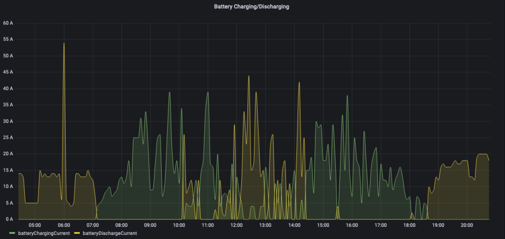

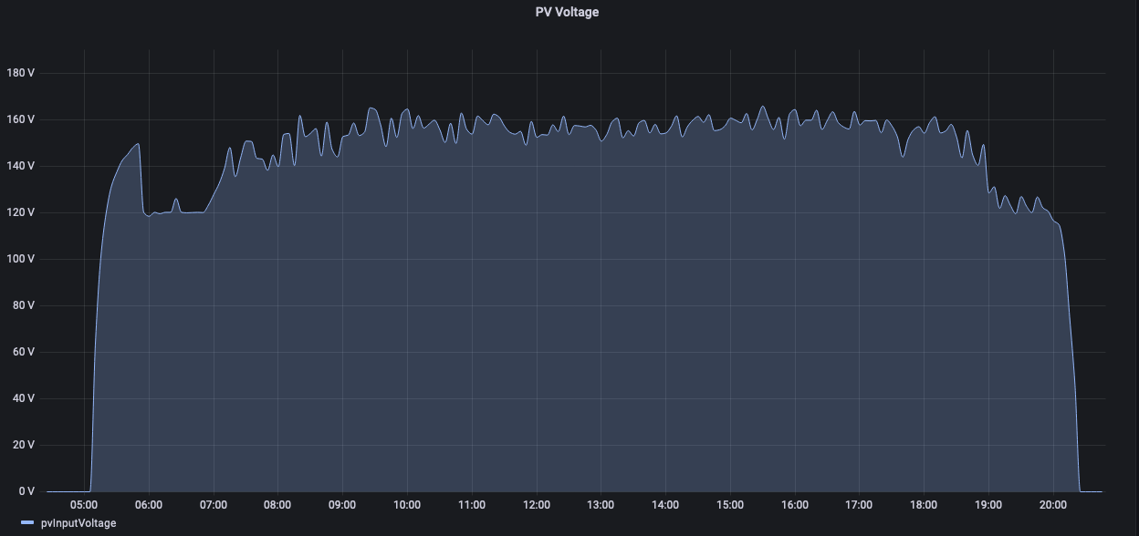

Hi everyone,
I have a Voltronic VM IV 3.6Kw with 5x550W solar panels installed in series. I've been monitoring the PV power and trying to maximize the PV production but the PV input never seems to stablize even on a clear sunny day, stable load and charging batteries. It keeps fluctuating no matter what, and my maximum daily PV production has never exceeded 12Kwh (is this normal for a 2.75Kw system ?). I've attached some screenshots of today's inverter data which was a very sunny day. Could it be a bad MPPT charge controller ? a firmware bug ? any idea ?
Thanks.
That's actually pretty good. One would hope for about 5 "full time hours of sun equivalent" in summer, 4 is doing well in winter. You can only expect to get 75-80% of rated power from panels, except for brief moments. So call that 2.1 kW; that's 8.4-10.5 kWh. So I don't think that you're losing a lot of production, despite the strange oscillations.
Thank you @Coulomb for the detailed explanation!! It's a relief that the production is normal and the numbers I have are in line with your calculations (Production of the last 30 days in the attached image).
I will try to experiment more with the different settings and maybe test a different inverter in the same setup. I will update this thread with the results, hoping one day they will release an updated firmware for the VM IV which solves this problem, without introducing new bugs!

I have finally managed to solve the problem by adding just one more solar panel!
My setup consisted of 5x 550 W TrinaSolar panels. These panels have a Voc of 37.9 V and a Vmpp of 31.6 V totaling 189.5 Voc and 158 Vmpp well within the MPPT range of the inverter (120-450 V) but for some reason it was struggling to keep a steady PV Power.
I just added one 555 W panel of the same model in series so the total Voc is now 227.6 V and total Vmpp = 189.8 V. The improvement was immediate as clearly visible in the graph below.

Good to see you are satisfied with the improvement upping the start voltage. The output now compared to your daily yield in mid July(about 8kWh) appears to be the same.
Do I miss something?
I also think what we see some MPPTs are indicated that the start voltage is 150+-10V. We should thus not rely on starting at 150V at all times.

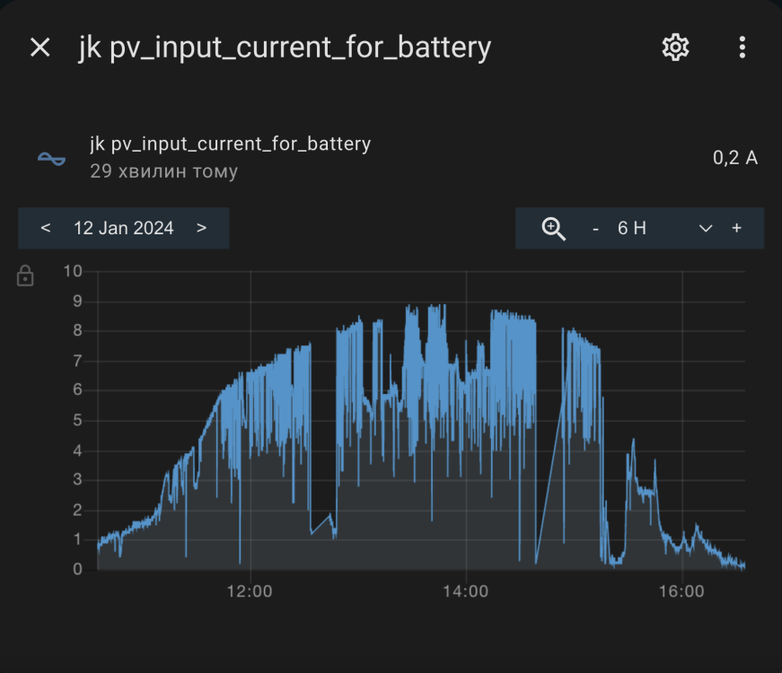

Hi everyone. I have the same problem but with Powmr POW-HVM PRO 6.2M-48V. But it's only fluctuate when SUB mode enabled and when at export to grid, in SBU mode works flawlessly without drops, and PV power always at highest point(SBU). My setups is 6x545 Longi solar(Short-circuit current 13.92 A, Open circuit voltage 49.65 V).
Please check PV current, voltage, and power production on attachments(it's sunny day without clouds).
Hope some one can explain such behavior.
