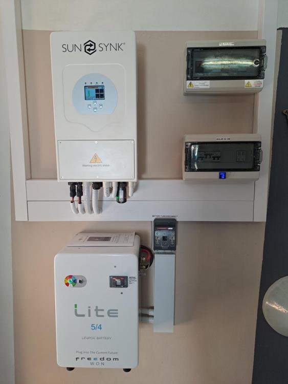

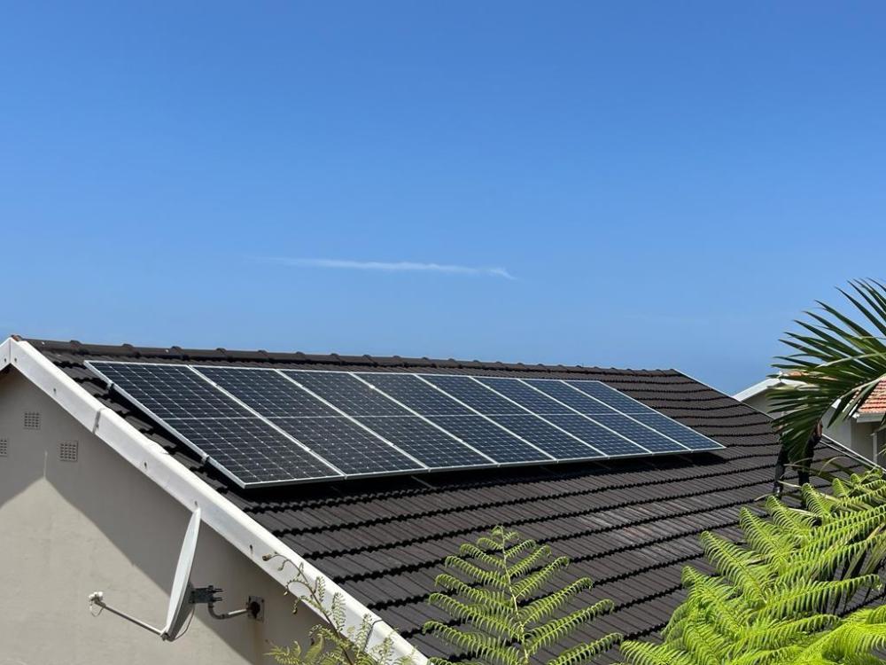

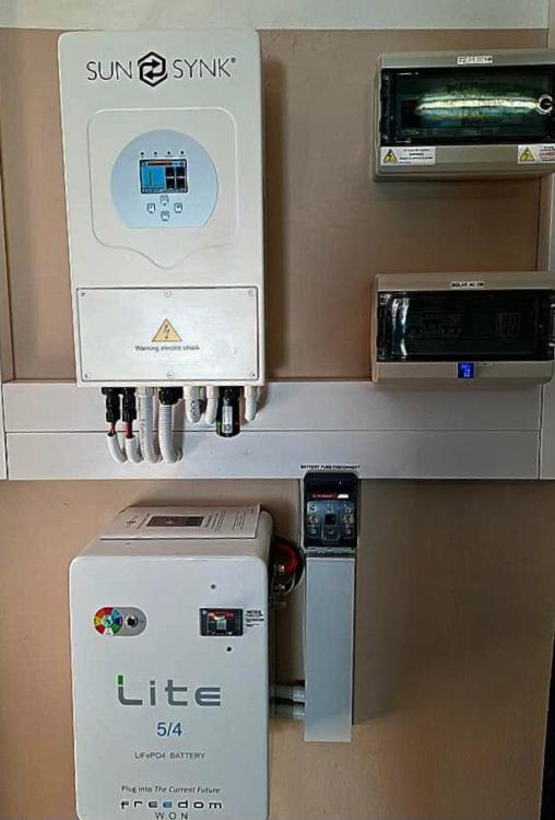

Another one bites the dust. 😝
Isn't that FW cute? But capable i am very impressed with the Freedom Won overall.

Very nice install @TaliaB i see you run the battery cables in seperate trunking. What is the maximum current the Freedom Won Lite 5/4 can deliver?

Thanks @Derek3yes i run the dc seperate from the ac then we are aligned with Sans 10142-1. The FW5/4 pack a punch max discharge 200 amps cont.discharge 100 amps. Charge current 100 amps true 1C
