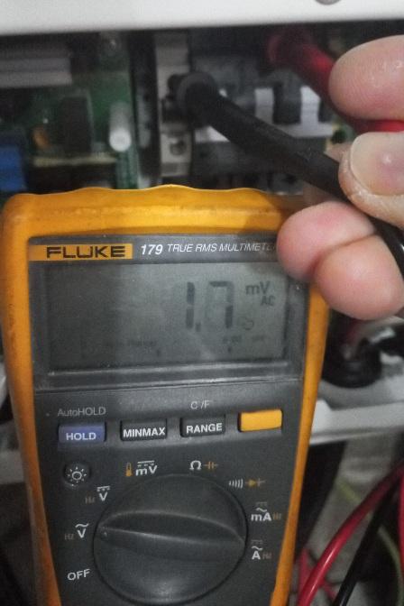

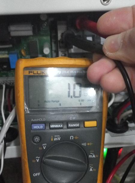

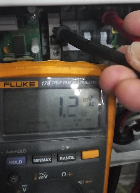

August 8, 20233 yr Author I checked everything again and can see no problem with wiring. This morning 0800 it tripped again without a change in loadshedding state. I noticed that when grid is isolated from the inverter, the AC light remains on and one of the phases indicate as 132v on the inverter display. Measuring with a multimeter however, show 0v between phase in and neutral.
