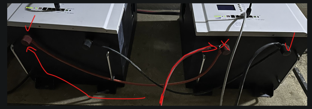

August 14, 20233 yr I have 2 Sunsynk (Deye) 5Kw connected in parallel, configured with two 10Kw lithium batteries (GeneralGold). They charge normally until they get fully charged then they start self consume down to ~95% then start charging up again. Primary inverter charges it while the secondary consumes or vice versa ONLY when fully charged, sometimes charge or discharge happen within 2 seconds on the same inverter. The batteries are brand new, not sure where to start debugging. Any help/guidance is appreciated. Battery specs: Same inverted within seconds: Battery Battery Config: System Work: Master Config: Secondary Config: Connection between inverter and batteries: Edited August 15, 20233 yr by Chrislo Added more images for the setup

August 15, 20233 yr Author Collected the requested info to add to the above: Battery Config: System Work: Master Config: Secondary Config: Connection between inverter and batteries:
August 15, 20233 yr Author 23 hours ago, TheMafiaMan - NotMuffinMan said: It is sounding a bit like a the parallel setup is not functioning properly can you possible post a picutre of the screen of your two inverters on the section which shows master/slave settings? one inverter would be setup as master and one as slave. Do you have one battery connected to each inverter or both going to one inverter? The switching you're descripting does it sound like a solenoid type switching on the battery end or is it on the inverter(s) side? Sorry for so many questions - the more info the better someone can help - i might not be able to but at least we would have more info to try figure it out if its only a settings issue ... Both batteries are connected together then connected to both inverters. When fully charged a small buzzing sound happens every few minutes in the batteries (they alternate) never happens before fully charged.

August 15, 20233 yr Hi Do you have a manual for the batteries that provides info on the parallel communication for the RS485 ports? We'd like to confirm they are correctly talking to one another [EDIT] Normally COMS#1 goes to COMS#2 for master slave communication, for instance RS-485-1 => RS-485-2(Please verify with manual) Please ask the technician to wire your terminals correctly, the battery on the right might take more load than the one on the left Cheers Edited August 16, 20233 yr by ZS1SCI

August 17, 20233 yr Author On 2023/08/15 at 7:56 PM, ZS1SCI said: Hi Do you have a manual for the batteries that provides info on the parallel communication for the RS485 ports? We'd like to confirm they are correctly talking to one another [EDIT] Normally COMS#1 goes to COMS#2 for master slave communication, for instance RS-485-1 => RS-485-2(Please verify with manual) Please ask the technician to wire your terminals correctly, the battery on the right might take more load than the one on the left Cheers Thanks the wire layout you suggested helped with having equal consumption between the batteries, now the charge capacity are similar. On 2023/08/15 at 10:19 PM, ZS1SCI said: Hey The work mode screen I was referring to My batteries also had some weird behavior with the BMS overcharging when this was just in normal non Time of Use mode(inverter default charge to 100%) Now the batteries still charge to 100% but they no longer exhibit the strange BMS behavior. Could be related or not Just for your information Regards Thanks for the info, I've set it to 98% just in case one of the batteries has already reached 100% to prevent having an average lower than one fully charged battery while one of the BMS is trying to discharge (one 100% the other 98%). This would help with night charging, do you know any option to control the % with solar panel charging? I'm still having the same issue but with lower dis/charge rate. Will be reaching out to a better technician to prevent any damage. Meanwhile I'm intentionally slowing down the charge rate to 0A when they reach 90%. I've seen that some suggested we use the use battery voltage option instead of lithium configuration, not sure if its recommended. Edited August 17, 20233 yr by Chrislo
