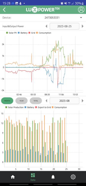

Here is another screenshot with a today's graph. The red is grid usage and you can see the inverter used some grid in addition to what it was already producing from solar.Screenshot_20230825_152840_LuxPowerView.thumb.jpg.4378df94ce06a144187d9f8d41e37856.jpg

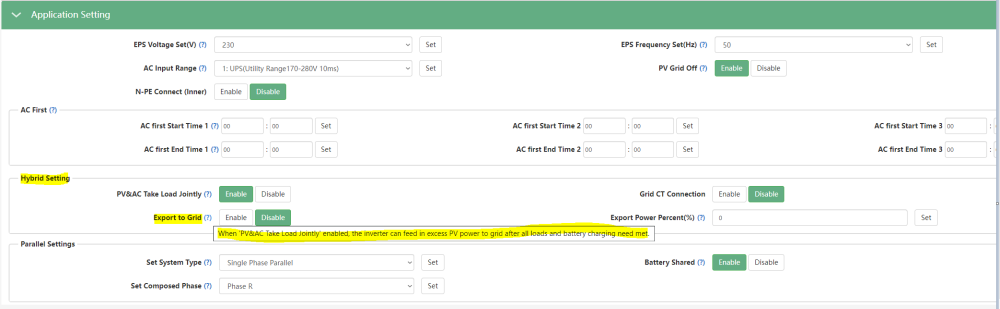

I have not looked into it, but I see there is an option in the Luxpower SNA5000 settings to export back to grid but have not tested it and cannot confirm whether it works or how well it works.
https://luxpowertek.com/wp-content/uploads/2022/02/ECOHybridSetting.pdf
The manual (page 5) states it can export to grid and I see that setting for my SNA5000 inverters and this is what it says when I hover over the question mark:

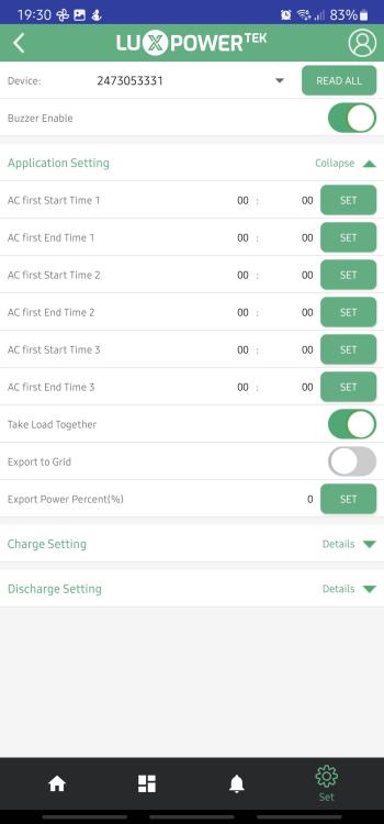

It's different on the app. It's still doesn't show it on mine.Screenshot_20230825_193032_LuxPowerView.thumb.jpg.cb8da541d16140ea1177e58fd5886746.jpg
Your export to grid is off and thus no % export selected. It seems you have it on the APP right at the bottom.
There was a picture showing you can enable CT coil which I don't where to find it.
