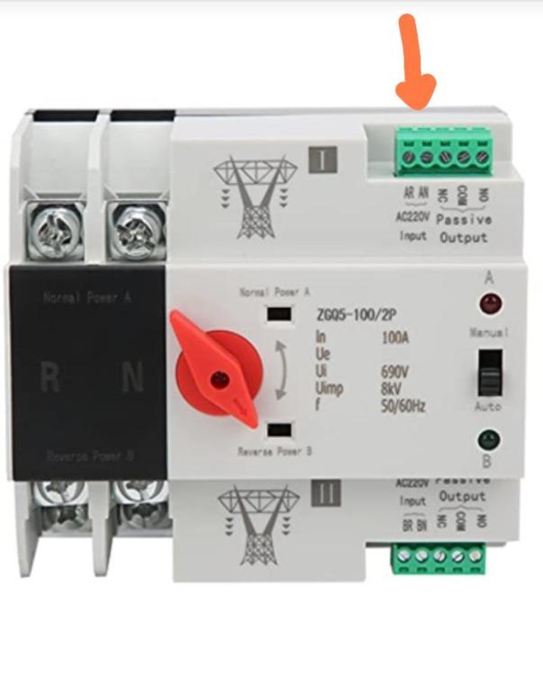

Hi Carnajo, these kind of ATS switches have a separate control input (AC) that you can connect to a sonoff device. This makes the ATS "smart".
Ah good to know, and I suspect that you then put it manual mode to disable the "auto changeover" function and have it fully controlled via app/homeassist etc?
You cannot control those ATS switches by applying power on the input in your picture. That input only supplies power for the NO/NC/COM relay but cannot control the switch itself. It's only for communication purposes.
27 minutes ago, PsyWulf said:
You could do this with an ATS like above + a Smart Breaker to cut power from the inverter output to your non-essential loads' "Inverter" input at the ATS,that would force it to revert to Eskom
Ah I see, makes sense. Will chat to electrician about doing something like this.
