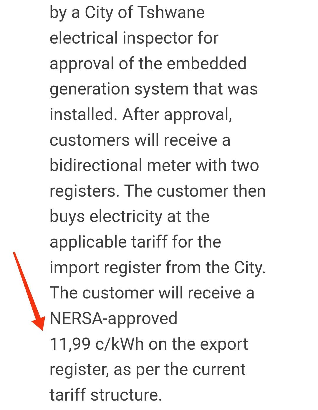

Let's add a bit of fat to this. Say you have 16 kWh a day to sell back @12c a unit as the last price I saw. This gives you less than R60pm. You cannot use the same prepaid meter and a bi-directional could cost R9000. Now I don't know if there are any admin fees.
Based on the above and current income from your feed in takes about 12 yrs to break even.
A lot better ways to spend the money. 🤔🤔🤔

I think you'll do better than 12c. But you're not going to get rich.
In COJ the buying price (what you pay them) starts at 2.77. They will buy back from you at 85.5c. So less than a third of what you pay them.
If you're already on the post-paid City Power tariff you'll be paying the same admin fees, so you can reduce your bill some, but you'll still be paying.
This assumes you don't pay for a new meter, and excludes any registration fees.

So 12c is then a good price 🤔🤔🤔
