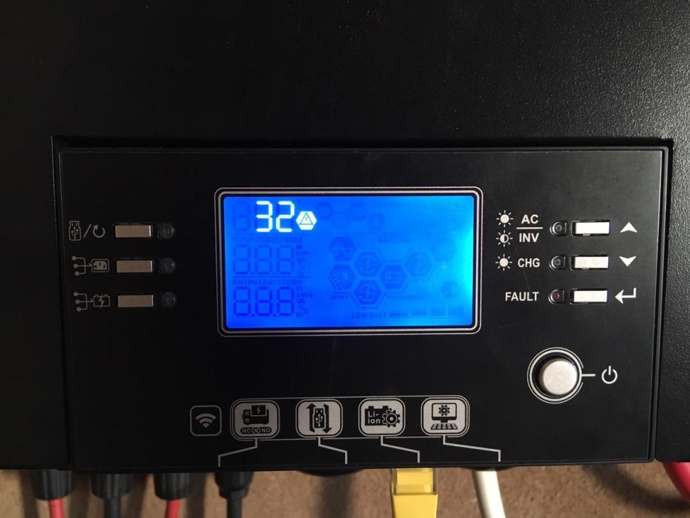

Kodak OG7.2 display fault 32. No comms via rs232 or wifi
Hoping someone can point me in the right direction...
After a particularly hectic thunderstorm, I lost comms with the inverter...
The display had the 32 fault msg, and I also discovered the rs232 converter in the cable connecting to my ESP32 was fried. So ATM I have no way of knowing what's going on in my system, other than the battery indicator on the batteries themselves.
Does this type of fault usually require the inverter to be sent in for service, or is there a comms module I can remove that might be repaired?

Heya @Ian
I had exactly the same problem this last August on my 7.2. I do not remember any lightning around the time, but my display got stuck at:
What I noticed was 52.4V between pins 1 and 2 of the display cable. So, it seemed like a short.
I bought mine in May. So, it was still under warranty, and sent the unit in for repair. The only information I got about the repair was:
> control board and remote was replaced, then tested working fine.
I've looked at my HA logs, and it looks like the unit went down before the thunderstorm, but I only noticed it later and assumed it was the lightning. Which makes sense as there was no other electronics affected. The Kodak is also not connected to any PV, which would be a lightning entry point.
Looks like it'll have to go in.
Thanks for the feedback
Ian
