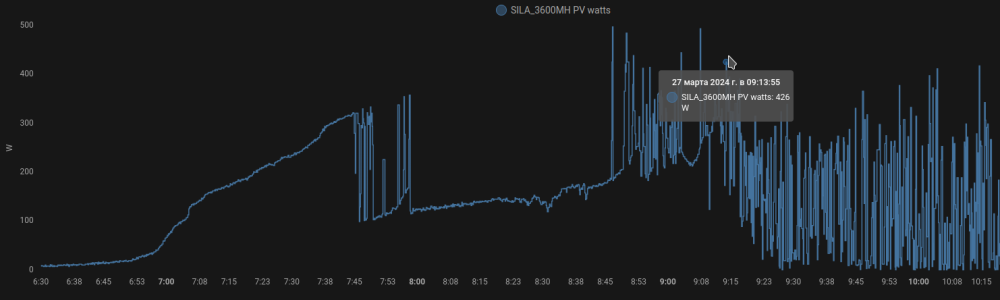

I have inverter "Voltronic InfiniSolar v4" and quite new (one-year old) pv panels that can potentially generate 1kw. At first, everything was fine, at sunny day they indeed were able to produce ~800w constantly for several hours. But, recently I started to observe the following picture (today's example):
Today is a perfect sunny day with clear sky, no shadows over the panels.
As you can see, at first the Sun is going higher as well as the generation. But then, instead of going up to the maximum generation, it starts to chaotically jump up and down, so that one second it shows 500w, the next second it may be even 0w (!) and so on. All that results in a very poor average generation, so that I receive only ~100-150w in average from 1kw panels in a sunny day).
Another strange thing is that at cloudy days the chart is way "smoother":
I.e. although the generation is quite low, but there are no these chaotic "hops".

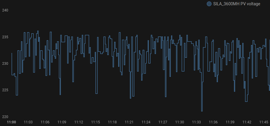

The inverter reports pv voltage is around 230 V:
Btw, when the inverter reports that the generation is 0w, at the same time the voltage is still as usual.

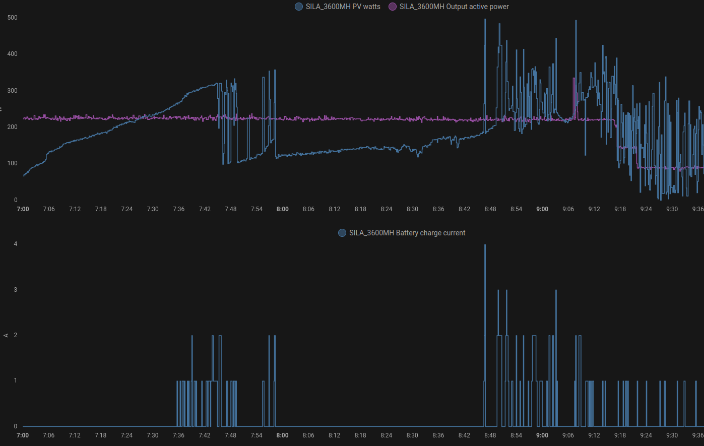

What is the load on the inverter output and battery soc it looks like the mppt is throttling( reducing) the current. Do you have a pv graph of the current
Edited by TaliaB
@TaliaB, I think you gave me the explanation! Thanks!
Now, when you asked to look at both generation and consumption, everything becomes clear:
When (active power + charging power) is more than the generated power, the generation graph is "smooth", otherwise throttling happens, which, on the graph looks like chaotic hops.
I thought it's an issue with my pv or inverter, but everything is fine, only a lack of experience from my side. Thanks.
