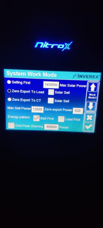

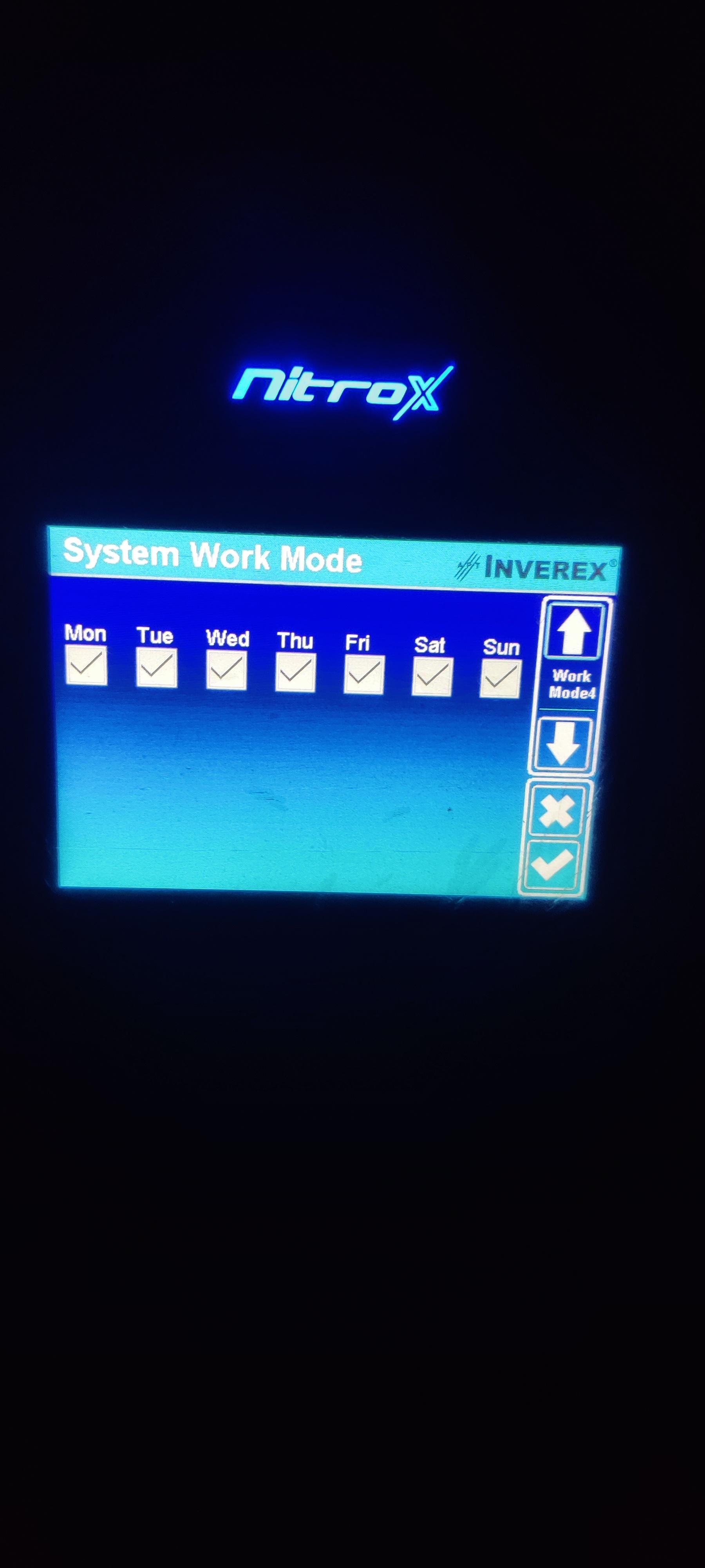

I have a three phase 12KW Inverex Nitrox(same as Deye) hybrid inverter which goes into a strange restart loop in the evening. The led lights on the inverter come on and off very few seconds. The screen does not turn on. It remains like that till the morning when sun comes out. This behaviour usually starts happening half an hour or so after PV stops producing any power.
I have no batteries installed. It is currently working as a grid tie inverter. I have attached some screenshots of my settings and inverter specifications. Any clue will be really helpful. Thanks

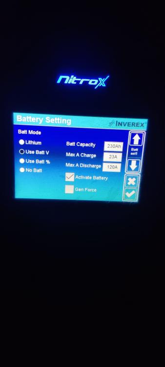

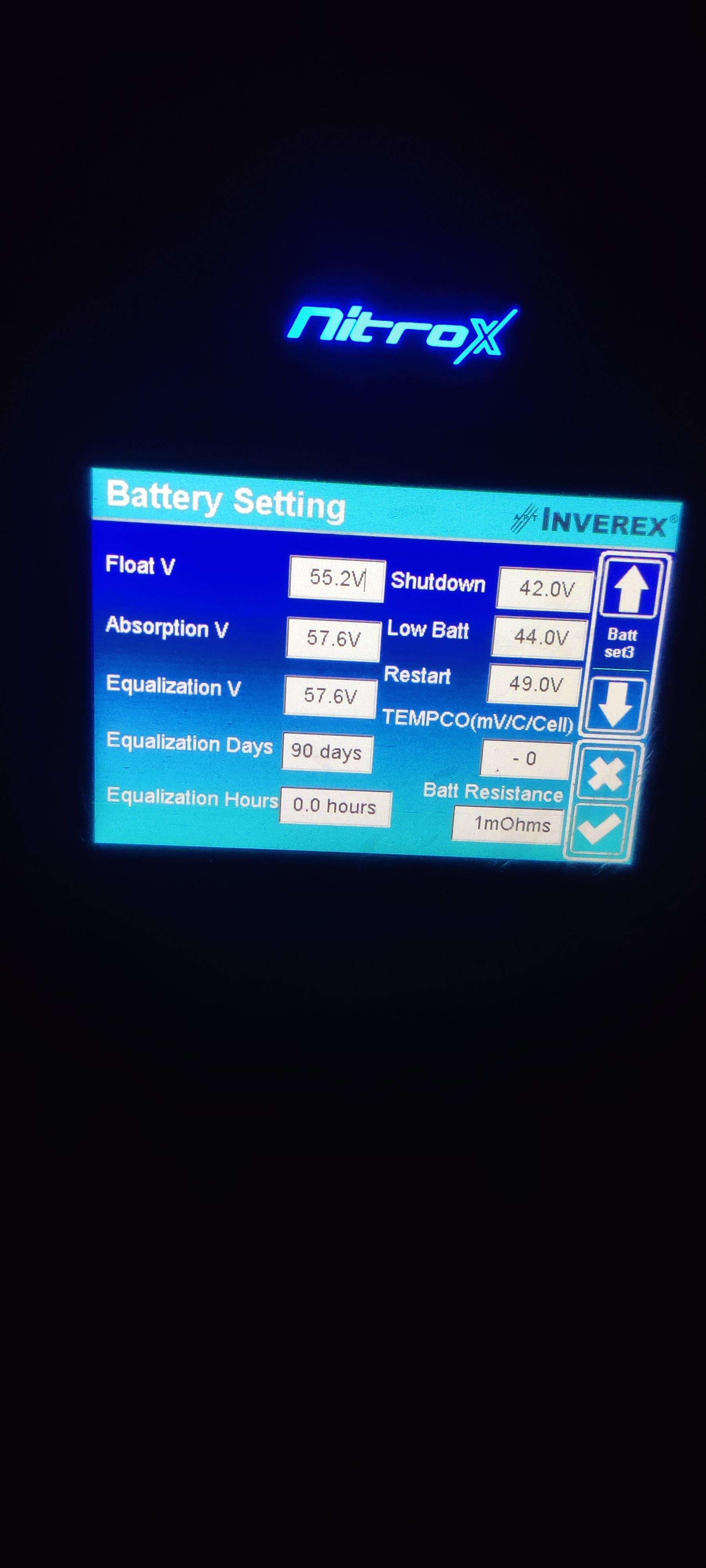

I have a newly installed Deye compatible (Inverex) hybrid 12kW inverter connected to new lead-acid batteries (4 x 12V 230AH) and 570W x 26 solar panels. This setup is installed 3 days ago. The inverter exhibits unpredictable restart behavior under conditions of grid going completely off and on:
  • Sometimes, it restarts when the AC grid power goes completely off. In this state the batteries are fully charged. Once the inverter restart completes it transfers to batteries for load. After a while it turns off non-essential load and keeps running the essential load.
  • In other instances, the inverter does not restart when the power goes off but does so 10-15 seconds after the grid power comes back on. During that time, AC power goes off and runs smart load, until batteries reach certain voltage at which point it turns off only the non-essential load and keeps running the essential load. In this condition, when the AC power comes back on, it waits for some time to connect/sync with grid and then restarts after which it again takes some time and then connects/syncs with the grid just fine.
This strange behavior is not always exhibited by the inverter. Sometimes either behavior is exhibited or no behavior at all. We have tested every iteration today and we could not conclude what the problem is. At one point we believed that there was a short circuit somewhere in out internal wiring, for which we turned of all the load that we suspected could have caused the problem. We have checked all the wiring connections to ensure that no wiring is loose.

Is the inverter putting out any faults? Anything showing on the Alerts page? Have you connected your three phase grid wires to the inverter properly like L1, L2 and L3? These have to be in the correct order to avoid any phase related issues. Make sure they are connected as they are coming from WAPDA.
Make sure that Zero-export Power in System Work Mode is set to at least 20W, preferably 40W.
Attach your settings for System Work Mode and Battery.

The installers verified all cable connections and made sure nothing is loose.
Attaching settings one by one.
