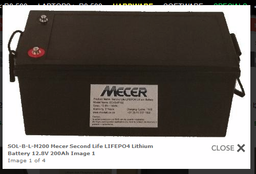

I also noticed these appear to be second life batteries?
Found these specs online, not sure if it is the same product you have?
https://www.mecerpc.co.za/Mecer-SOL-B-L-M200-p-239794.php
SOL-B-L-M200
Mecer Second Life LIFEPO4 Lithium Battery 12.8V 200Ah
Mecer second life LIFEPO4 Lithium Battery 12.8V 200Ah, 1500 charging cycles, Can use up to 4 batteries in series with the built in BMS (Battery Management System) **6 month warranty or rated cycles, whichever comes first
