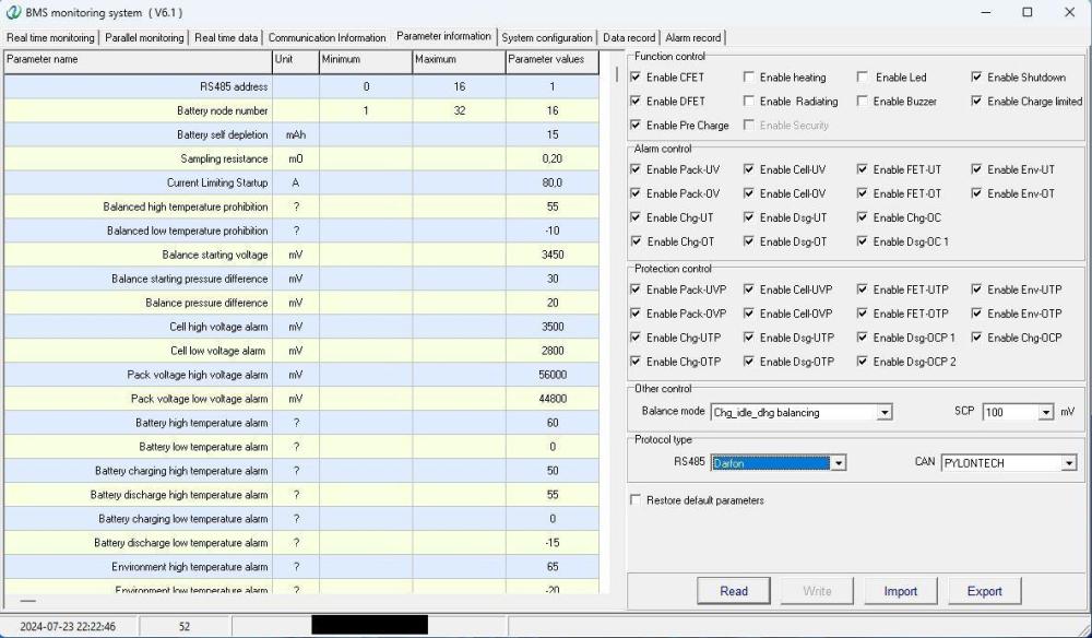

You may want to take a look at "System Config" tab. That will show how the battery is setup. Quite a number of parameters, but you will see things like OVP (Over Voltage protection,  & e.g. when the balancer (if BMS has the functionality) kicks in. (+-3.65V, if i remember correctly). In there you should also see what Protocol the BMS support/talks. Pylontech seems to be the most prevalent.

I poked around, and maybe the parameter tab shows what you are talking about. You're right there are a ton of battery configs in there, need to be super careful not to accidentally change something lol. yip the balancing stuff is in here too, 3.45V on this one.image.png.464932a7aeae0d4c50b9e20d62d02b0e.png
WRT the protocol, I'm not very clear on the RS485 vs RS232 distinctions, but RS485 is set to Darfon. Pylontech is in the dropdown but i'm way too nervous to make any changes :). CAN is on Pylontech though, and as I understand, that's the protocol that the inverter wants...?
