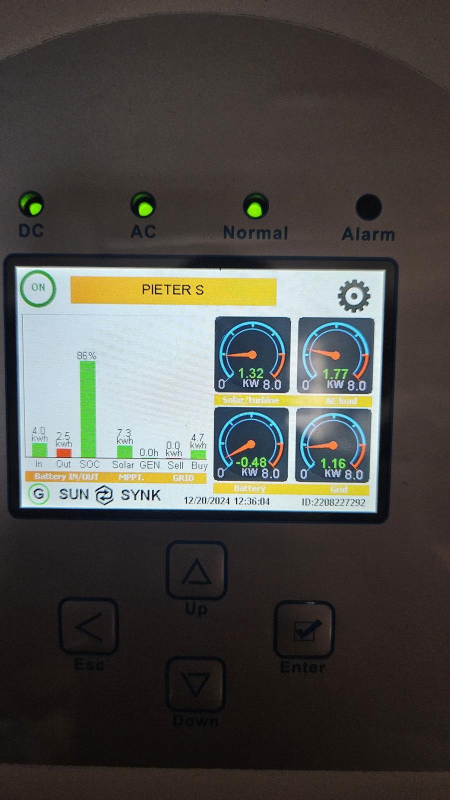

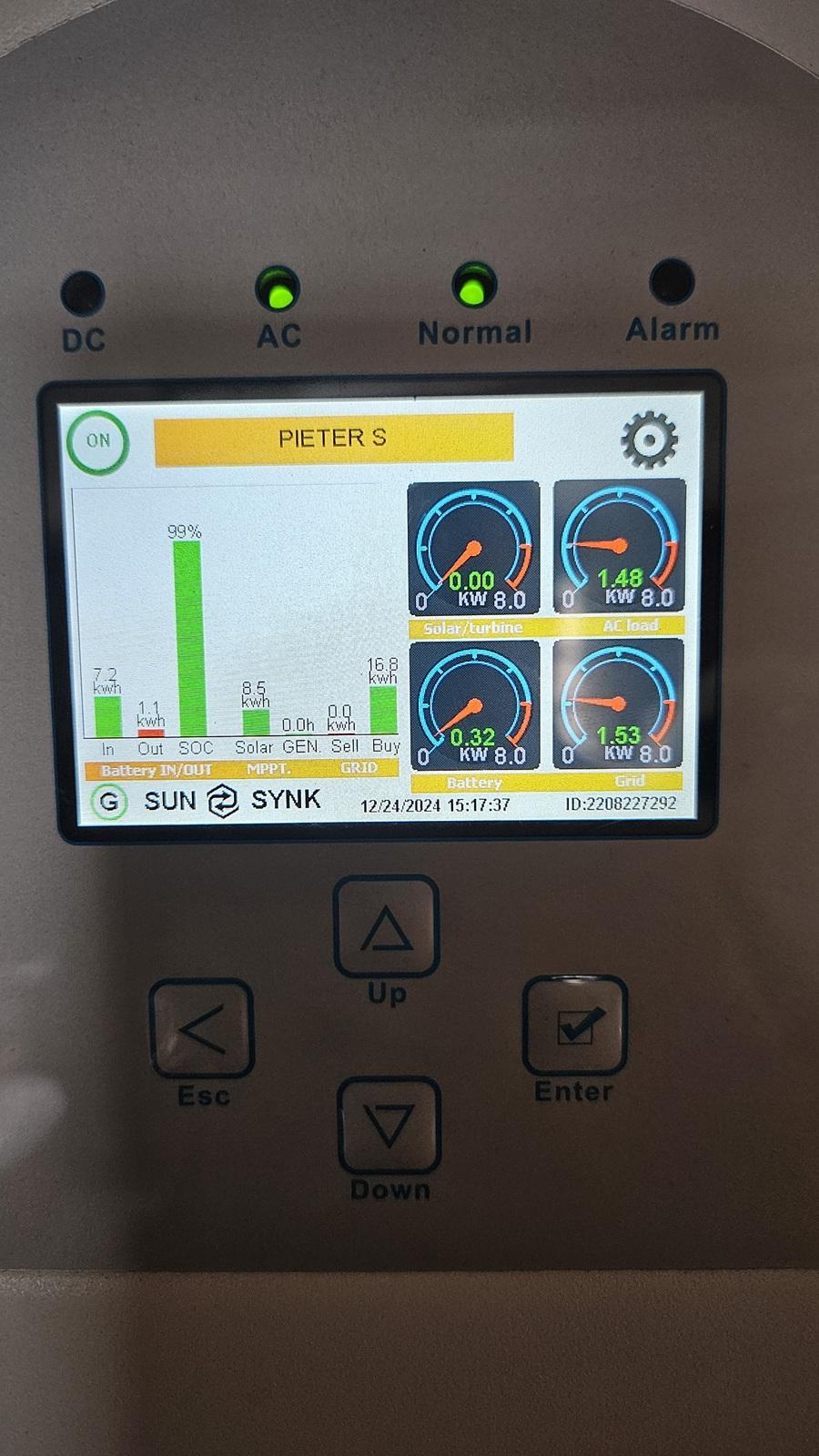

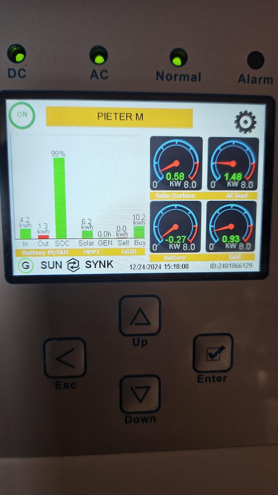

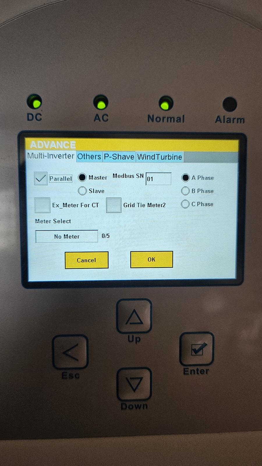

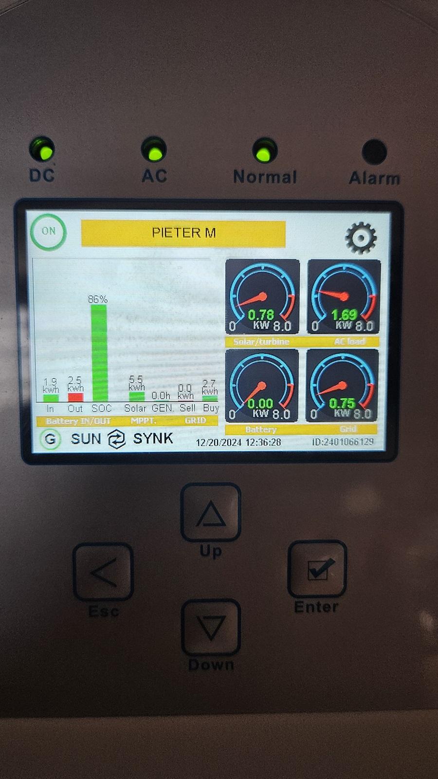

I recently had a second inverter installed in parallel. My issue I have is as per below.
The slave inverter will always charge the batteries between 400-500watts, will even take some grid to do so if there is not enough solar. Where the master will stop charging when there is not enough solar.
So the salve will use more grid as it uses the extra 400-500watts for the charge (even is the timer are set to 50% and the batteries are over 50% it still charges)
Timers as all correct
Batteries are connected to a bus bar and then to the inverters
Inverters are connected with the yellow cable from Sunsynk and both inverters parallel dip switches are "on"
Your help will be much appreciated!

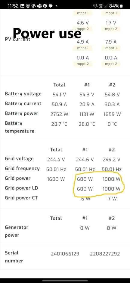

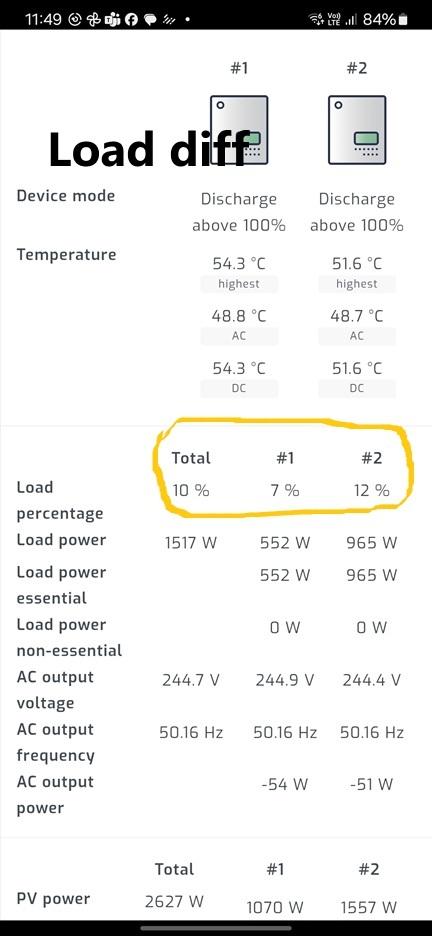

Ok so what I have found is 2 issues.
1.The Master and slave does not split the grid/load load 50/50, the slave uses almost 890w more than the master when the load is higher.

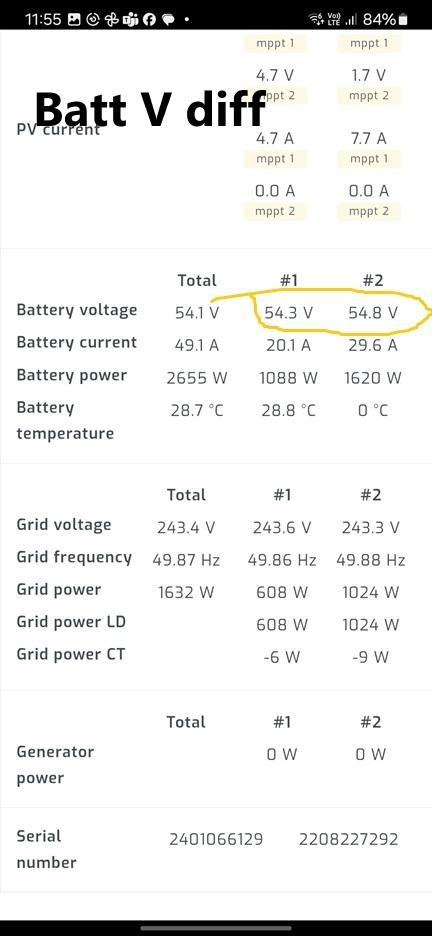

2.The slave see's the batteries as 0.5V higher than the master.

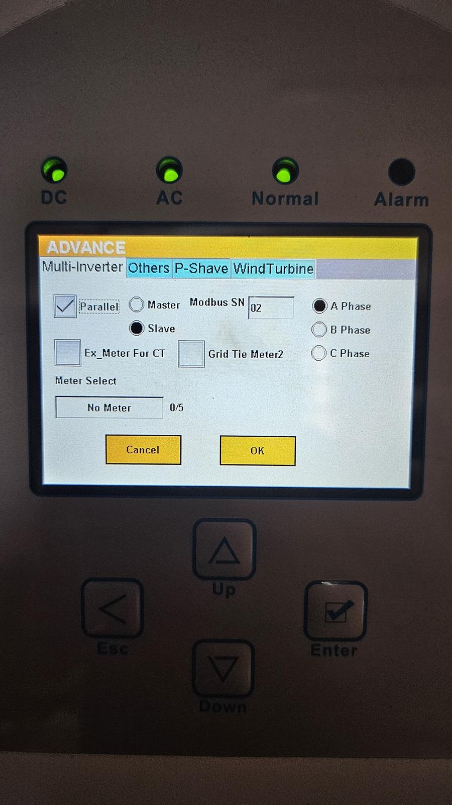

I Connections.
Comms cable in Master parallel B and Slave Parallel A
CT Coil on master only
So I really do not know what to change as I have tried all settings.

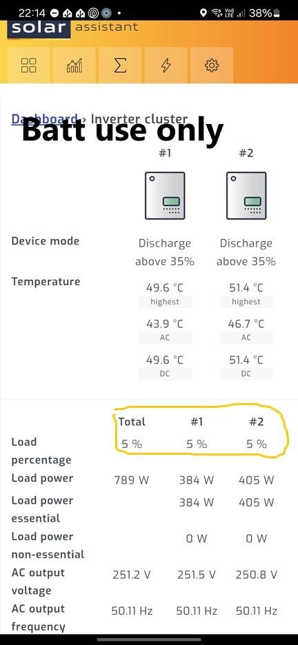

When running on batteries only the load and use is split 50/50
In my system, both report the same battery voltage. How are your batteries connected to the inverters?

Yes if ons batteries everything in 50/50 but when on grid the split is not even close to 50/50 (not sure if this is normal or not)
1 hour ago, Steve87 said:
Looks like your PV Arrays are not equally split? Can you comment? Usually if the PV Arrasy are not an equal split the machine that has more PV power available will work harder.
Hi Steve87
Correct my strings are split in 6x 460 and 10x 460 panels due to shading from a neigbours tree. The bigger array is on the slave inverter.
The slave will also work harder on grid at night when no PV is available but only on grid, as said when on batteries the load is split 50/50
If it is the case that the one works harder than the other and there is no issue with it then I leave it as is as there is no ill effect that I can see other than the numbers that is not equal.
There is no adverse effects. Try this to be absolutely sure. Switch off the Solar PV on the Slave for a few minutes, then observe the results. You will find the Master doing most of the work. This is a Sunsynk/ Deye thing. Voltronics and just about every other manufacturer I have cross paths with don't behave like this. Took me a long time to make this observation. We had a site that had some major issues & was back & fourth with machines in parallel then not...

I am getting the same voltage reading on both inverters. Max. 0.1V difference

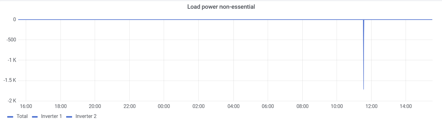

I also get something weird running on grid. My Total Load is relatively even split:

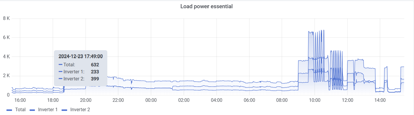

However, when looking at my Essential Load, the Slave is carrying a higher load than the Master:
And for some reason, the Master is reporting a Non-Essential Load while the Slave is reporting a negative value for Non-Essential Load. This is particularly strange as I have no load connected to Non-Essential. It appears that the Master is pushing current across to the Slave:
When disconnected from the Grid, Non-Essential Load is 0.
Are you seeing something similar in your system?

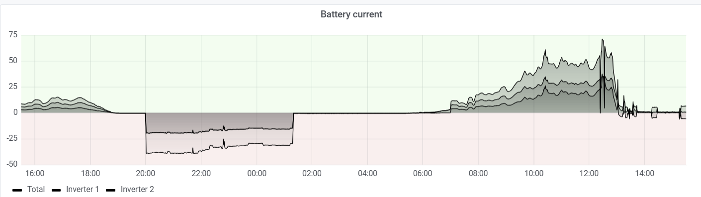

The other thing I have noticed is that the Slave is drawing significantly more from the batteries when running on Grid:
Does this also occur in your system?

16 minutes ago, Zeus-JKR said:
On the battery current, when you zoom in on the time period that your system is running on Grid (e.g., 02h00 - 04h00), is the battery draw still the same for both inverters?
Strange - so we both get a higher Essential Load on our Slave, but seemingly caused by different things...

Yes battery current still the same between 2 and 4.

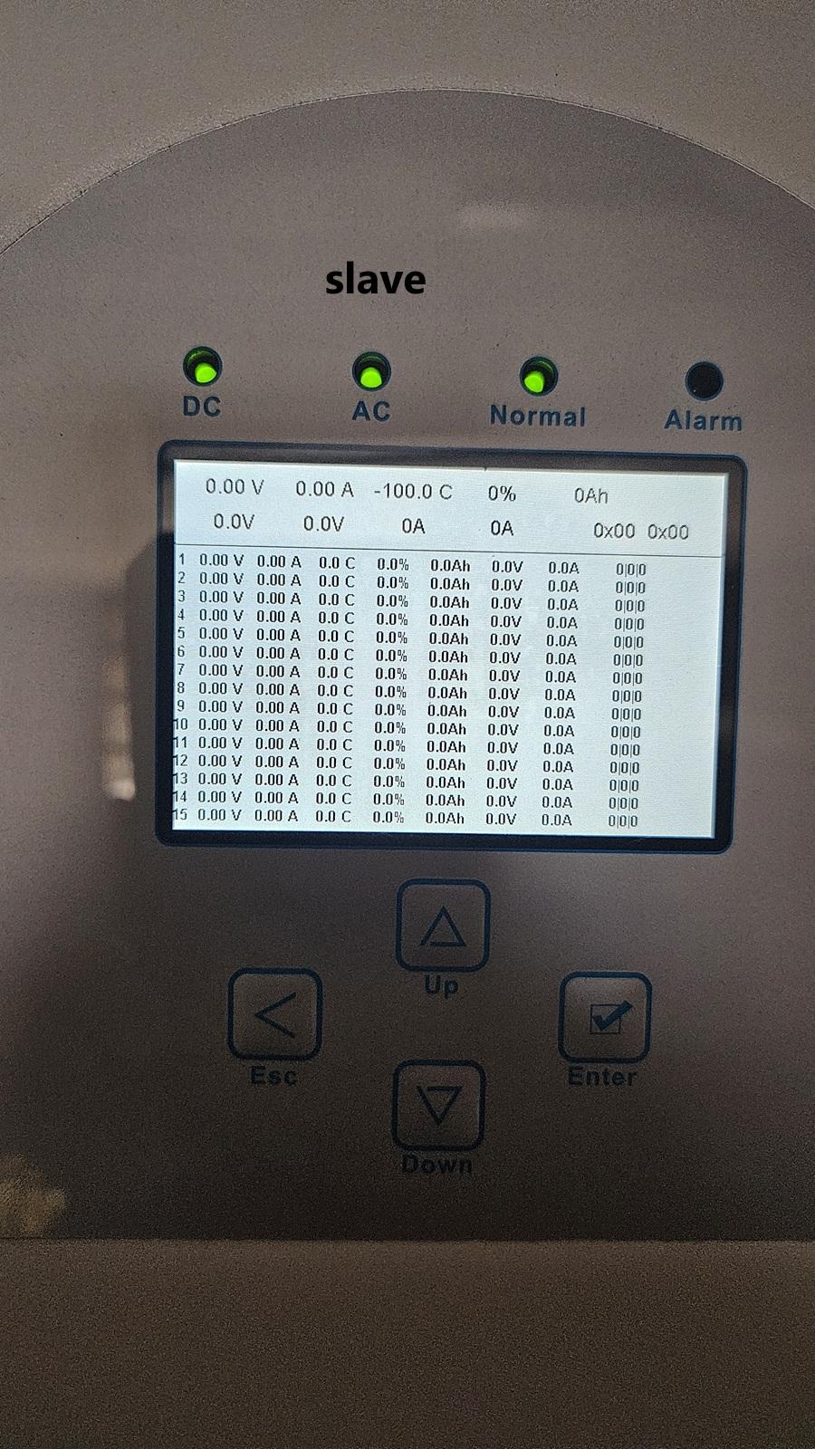

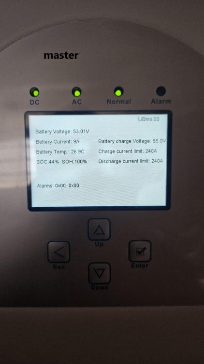

Just want to find out is this correct of maybe my issue?
The master shows die batteries BMS but the slave inverter does not, please see below and advise if this is normal or not.
Same on my side. I think this is because the BMS is only connected to the Master - and the Master does not seem to communicate the details to the Slave
