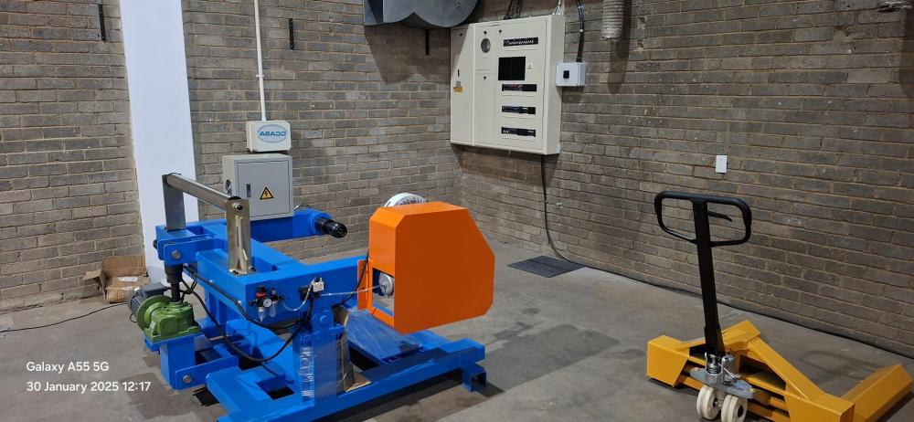

Checking with the experts on any specific SANS requirements to install a operating machine close to a 3 phase DB board. Must there be minimum distance between machine and DB board?
Appreciate any feedback,
The DB must just be easily accessible for sparky to work on.
For safety and peace of mind, leave 1 meter minimum clearance. The machine must not affect the DB in any way. Sparks, material used on the machine etc.
