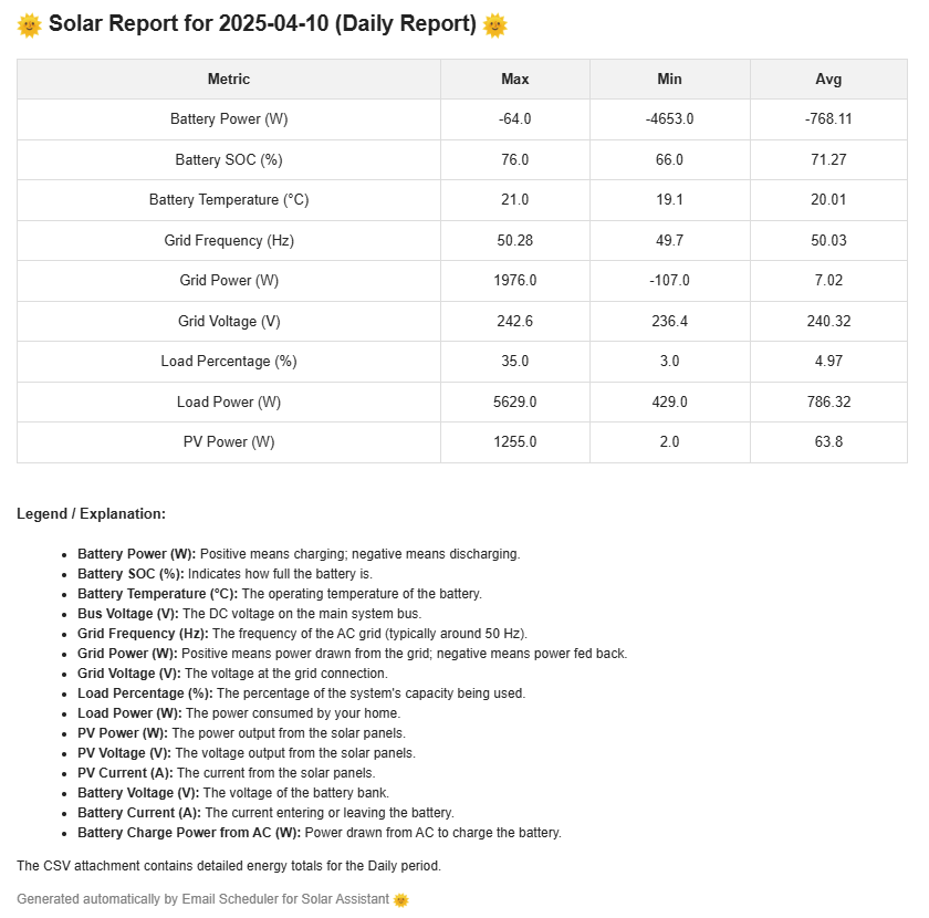

Thank you so much for this! I set up a docker on my homelab last night, and it's working as intended. Any chance that a report can be sent to two email addresses? Attached is an example output I got for someone who wants to see what the report would look like.

Your are most welcome and I am glad it helps you. With regards to this report being sent to multiple emails, I can most definitely build in the functionality for you. I will see if I can get to that either today or tomorrow.

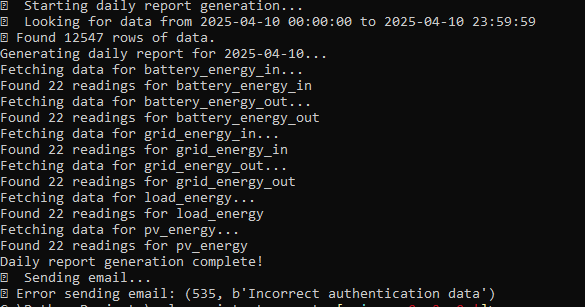

  1. The Email sent successfully text still gets sent on the Log even though it failed. (I entered the wrong password.)
  2. Do I need to rebuild the docker image for the CSV Report = 0 to work? I changed the env variable and restarted the container, but it's still sending me the CSV.
Please pull the new version and test. I just cannot test at the moment. The success message should not display if the email fails. Also you should now be able to set the csv attachment to 0 and should just need to restart the container to take effect.
I still get the same success message after an error with the email password.

Ah I found the issue. There was an additional success message being printed from the report_generator.py where the emailer.py already handled that part. Should be fixed now.
I inputted my email password incorrect to replicate your use case:
Just do a pull again and rebuild and you should be good. 🙂
