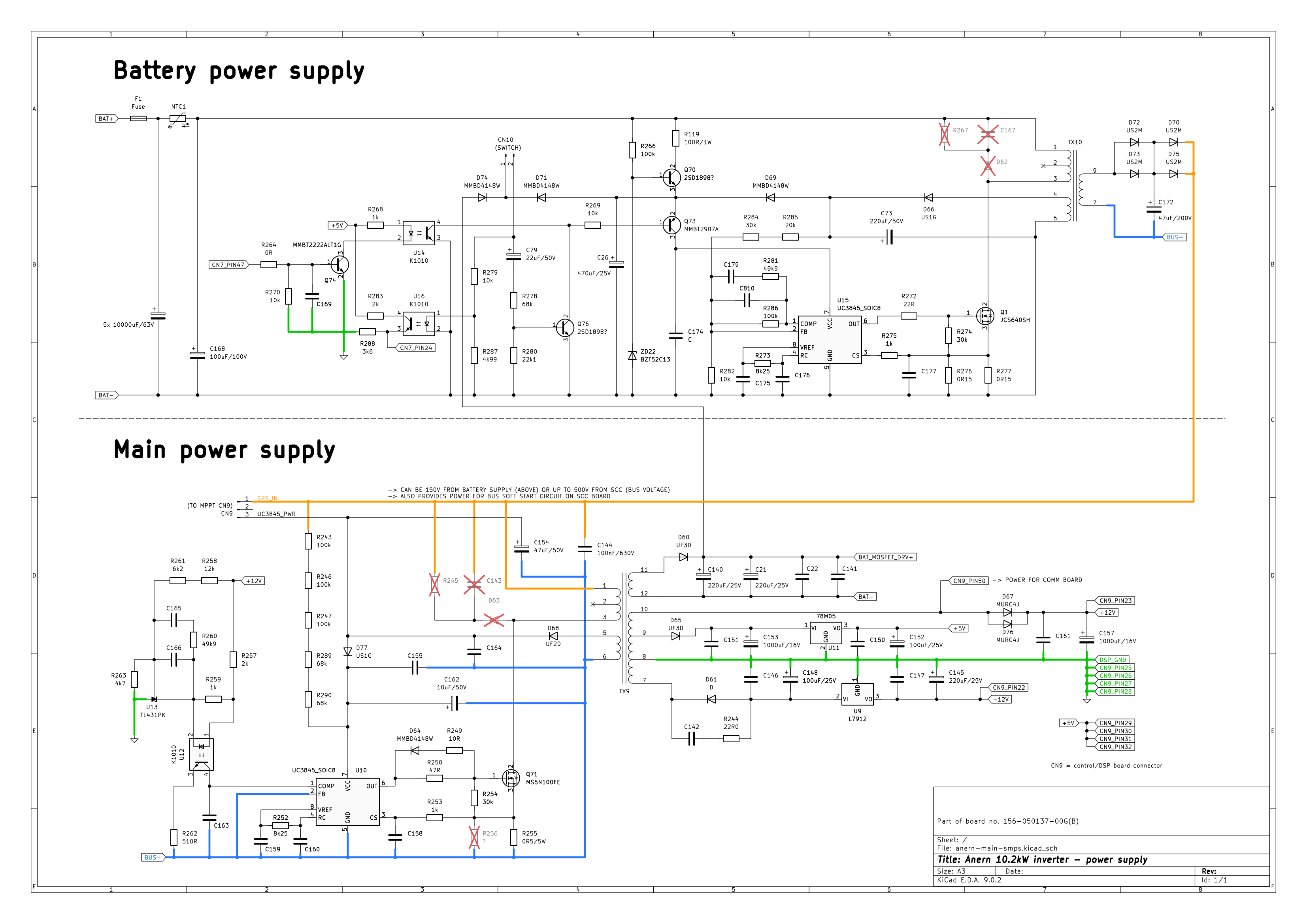

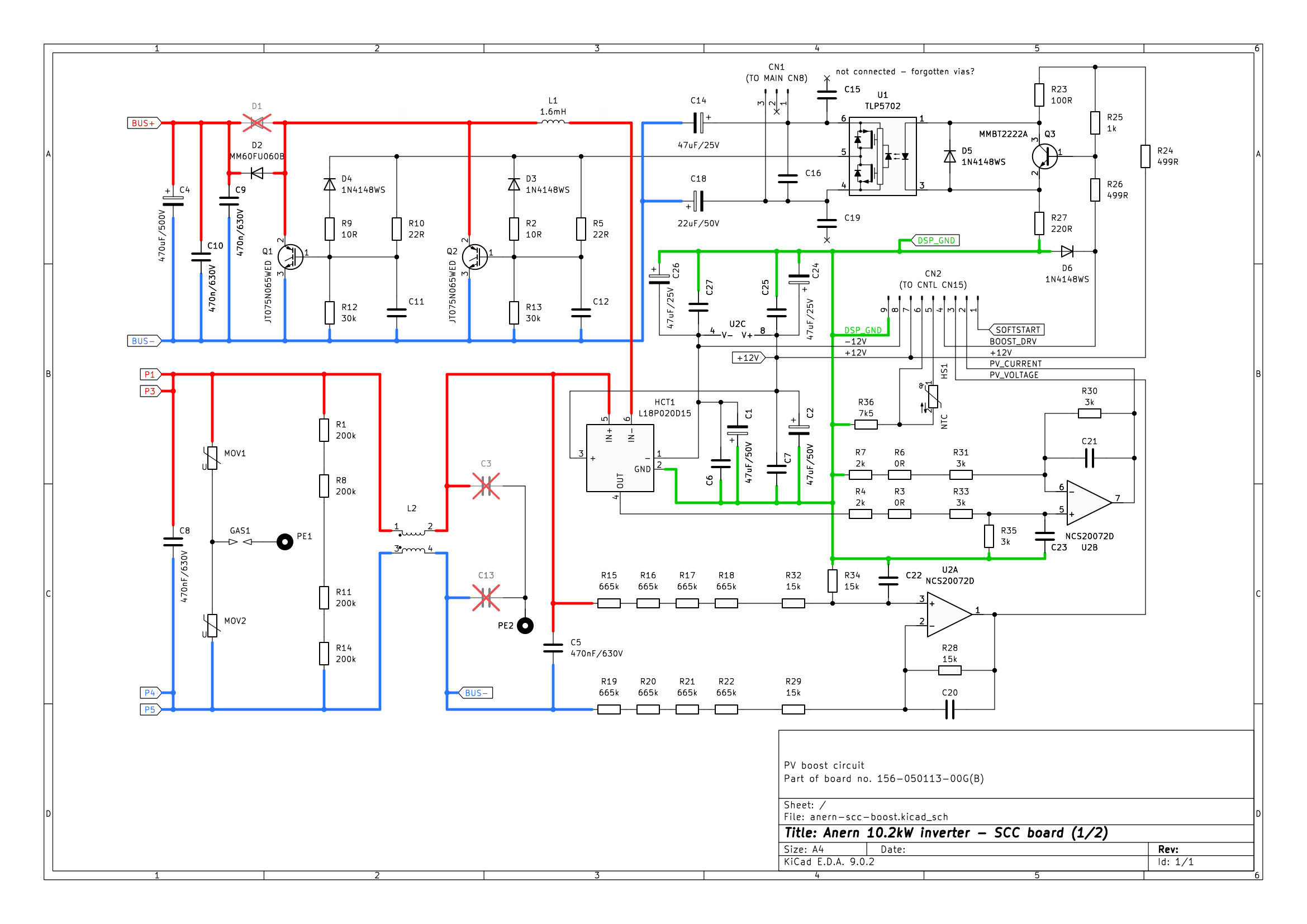

May 19, 20251 yr Here are some schematics that I reverse engineered from Anern Victor Max 10.2kW inverter. Should be very similar to Axpert VM models. Of course, part references and connector pinouts are different. Also ADC and GPIO assignments do not match genuine Voltronic's.The SCC board schematic is complete - PV boost circuit, voltage and current measurement, AC power supply and bus soft start circuit.Then there's a schematic of the two power supplies on the main board - this inverter uses an auxillary 150V power supply to start from the battery.Also a I attempted to trace the analog part of the control/DSP board. This was little bit harder as there were no printed part references on the board. But all op-amps are there, nothing important (for understanding the circuit function) should be missing. [15/Aug/2025 added the remaining "digital" part]I think there will be some errors, so every feedback is appreciated. I can provide KiCad project files if anyone is interested. Edited August 24, 2025Aug 24 by kuba.cz

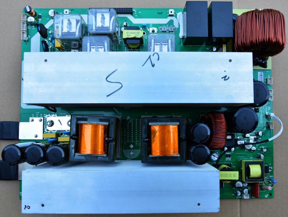

July 19, 20251 yr Looking forward for your drawings. In mean while can you share high resolution pictures of Main Board, MPPT Card and Controller card, either in full or in parts. Both sides of PCB's. Thanks
July 20, 20251 yr Author Here are some photos. Not great but I tried my best.To avoid confusion, I have to note that I've made some modifications on the main board. I have three of these boards (got them as not-working) and all of them had signs of arcing around the drain of Q71 or TX9's primary winding. On this particular one, U10 and R255 was faulty. There were some unsuccessul repair attempts from the previous owner.After replacing the parts (including Q71 which still measured OK), I decided to also remove R249/D64 and install the unpopulated RCD clamp to reduce the voltage spikes. Used 3.3nF capacitor for C143, 150k/3W resistor for R245 and some diode that I don't remember. That didn't work out, the same parts blew again after a few power ons (exactly when the soft start turned off and SPS_IN raised to the bus voltage). BUT most likely due to my mistake that I didn't check R253 which was already open-circuit. Wrongly suspecting the RCD clamp's diode to be too slow, I deciced to try an RC snubber instead, consisting of a 100pF/3kV MLCC capacitor and 33R/5W resistor, connected between source and drain of Q71. Only then, watching the waveforms on the oscilloscope, I realized that the duty cycle is constant 50% and the power supply keeps switching off and on by the optocoupler feedback. That lead me to the R253 1k resistor. After replacing it, everything works fine and the waveform on the drain of Q71 looks nice so I left the RC snubber there, not trying to revert to the RCD clamp. So that's the current state of the main board on the photo.Also I swapped the DSP, the orignal one was TMS320F28062PZT, this one is TMS320F28066PZT (differs in memory size), but this is only related to my experiments, not a malfunction of the inverter.

October 11, 2025Oct 11 Author On 2025/10/02 at 2:51 PM, RickH said:Can anyone advise the size of resistor marked R255 to mine has burnt.It's in the schematic, 0R5, like 0.5 Ohms. 5W rating is just a guess, it's probably less, maybe 3W. You can also use two 1 Ohm resistors in parallel.If it's burnt, you need to check other components as well. Especially Q71, U10, R253, R250, R249, D49. You may also want to add an RC snubber or RCD clamp to prevent the same failure happening again (see my earlier post - the one with board photos).

November 10, 2025Nov 10 is it safe to run the Main power supply without the RCD Snubber circuit? i got one inverter with failed UC3845... but the Q71 mosfet is not damaged. this is the first design that i see without RCD Snubber. Is this cost saving or something else?
December 8, 2025Dec 8 On 2025/11/11 at 1:42 AM, sethmad said:is it safe to run the Main power supply without the RCD Snubber circuit?This is not my area of expertise. But my guess is no, it's not safe in the long run; this seems like the worst kind of penny pinching to me.
December 8, 2025Dec 8 Author On 2025/11/10 at 4:42 PM, sethmad said:Is this cost saving or something else?I'm not sure what was the reason to remove the snubber, but the power supply seems to run fine without it as long as the output current stays within normal range. But when there's a short circuit (and that can be on the COM port also), the voltage spikes can be high enough to cause arcing on the transistor drain or transformer pins.If UC3845 failed, don't forget to check R253. The power supply may run even if this resistor is open-circuit, but UC3845 will stay at 50% duty cycle, just switching on and off according to the voltage feedback. In this mode, the spikes on the primary will be extremely high.Currently I'm running two inverters with RC snubber added between source and drain of the MOSFET without any issues (that's not an RCD clamp as show in the schematic). I used 100pF/3kV MLCC capacitor and 33R/5W resistor as already mentioned.
