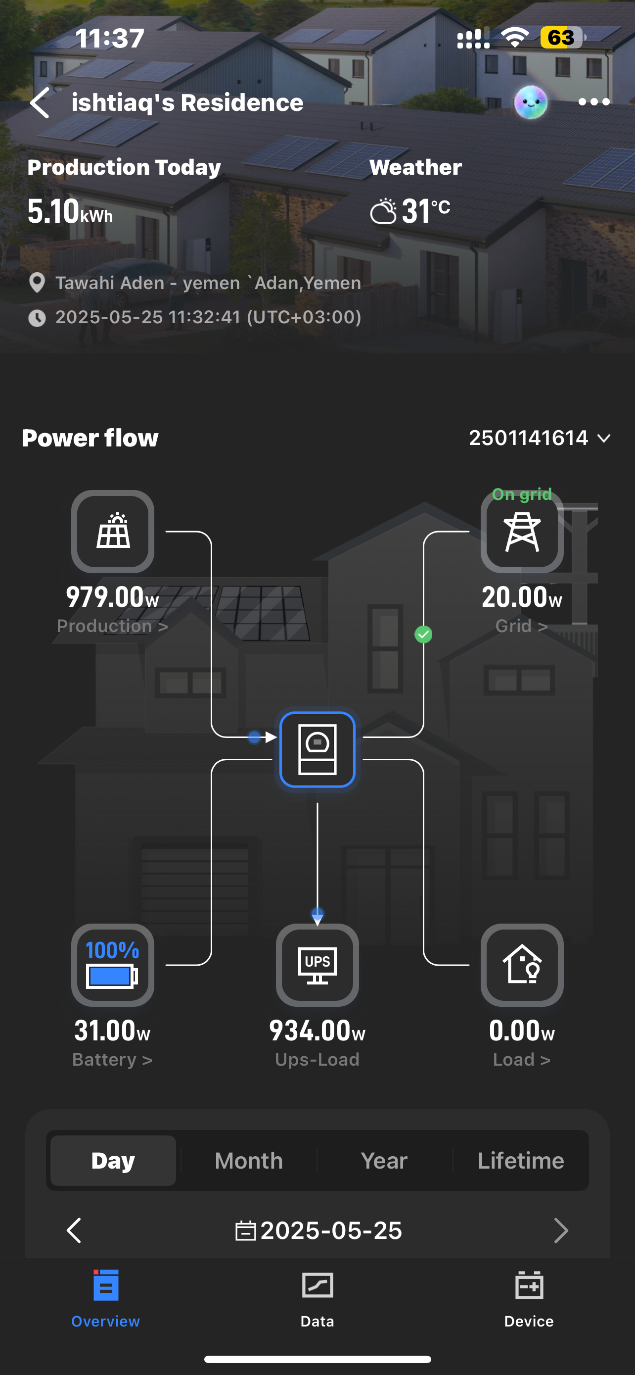

I am writing to report a critical overvoltage issue in my solar energy storage system and request urgent technical assistance.
System Configuration:
  • Batteries: 4x PylonTech US5000 (parallel connection, CAN protocol).
  • Inverter: Deye SUN-8K-SG01HP2-US-AM2.
  • Communication: CAN/BMS protocol enabled, no explicit errors logged.
Issue Description:
  • During charging, the battery via grid voltage spiked to 56.94V, exceeding the US5000’s maximum safe limit (53.5V - 56.80).
  • The Deye inverter halted charging automatically during the event.
  • No communication errors or overcharge alerts were reported by the inverter.
