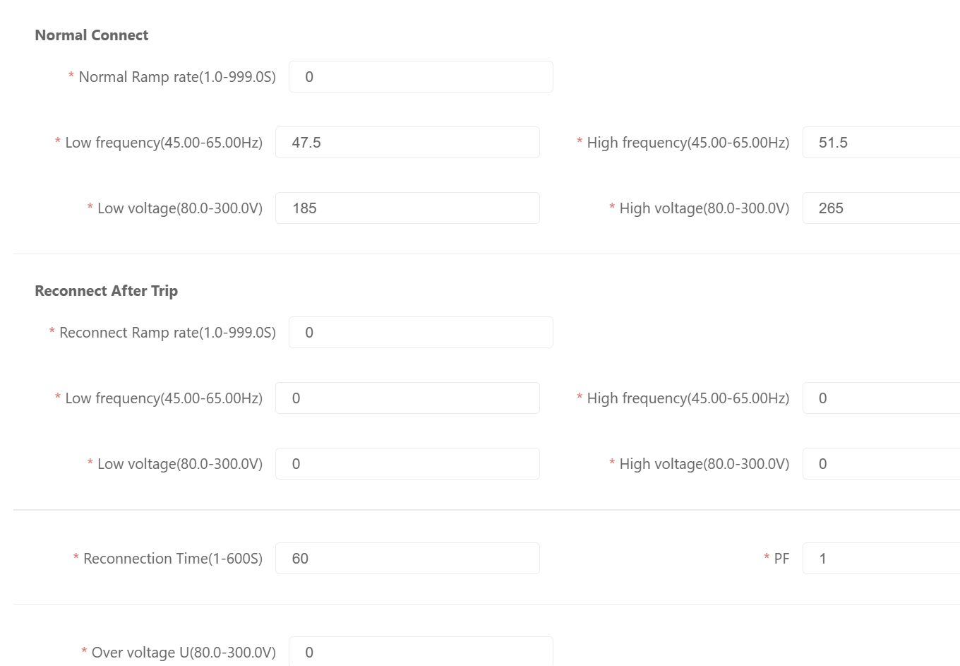

I did look at the setup and the range is very wide, 185v to 265v , and 47.5hz to 51.5hz , i have not seen anything near those limits in the graph data to be honest.....but it could be a small spike not got by the data polling interval of the sunsynk software.

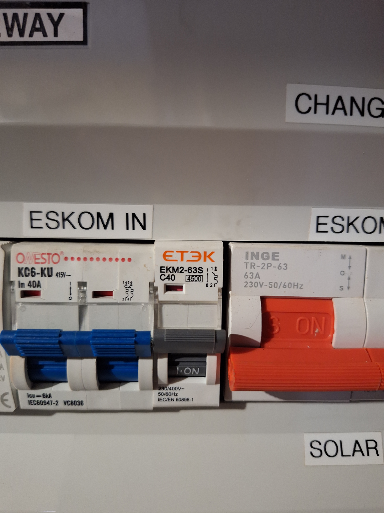

I have now had two trip happening on a breaker switch, it is labeled as Eskom IN and has a 40A breaker. This breaker trips 22:55 at night.....(now two nights in a row) . See the picture below for the Grey/black breaker that trips .
Could this be that the breaker is faulty ? Why would it trip if the house is running of Battery at that point and only the trickle feed is coming from eskom at 30w. is a 40A breaker fine for a 8800w inverter with the entire household + geysers running through it ? Surely I might pull 9kw or 10kw at points ?

Well the breaker is rated for 9200W. Should have been at least a 50A, even 60A as if you have a load of say 6kw and turn on a microwave that is typically 1.7kw, as uch as the running power is still under 9.2kw, a microwave has a big start up current which can easily cause nuicance trips. Your inverter can do 2x the rated power for a short while safely. You will keep getting nuicance trips anytime a load such as a pool pump or microwave turns on.
As for your weird trips, if you exceed the rating on the inverter, even temporarily, the inverter automatically switches to grid to supply the load. This is at least how most inverters works. I suspect this is what is happening. You are going over the inverter rating for short bursts and the inverter switches to the grid. But because your breaker is small, it also trips the breaker at such instances. This is what I suspect is causing your issues. Why it happens at 22:55 makes no sense to me.

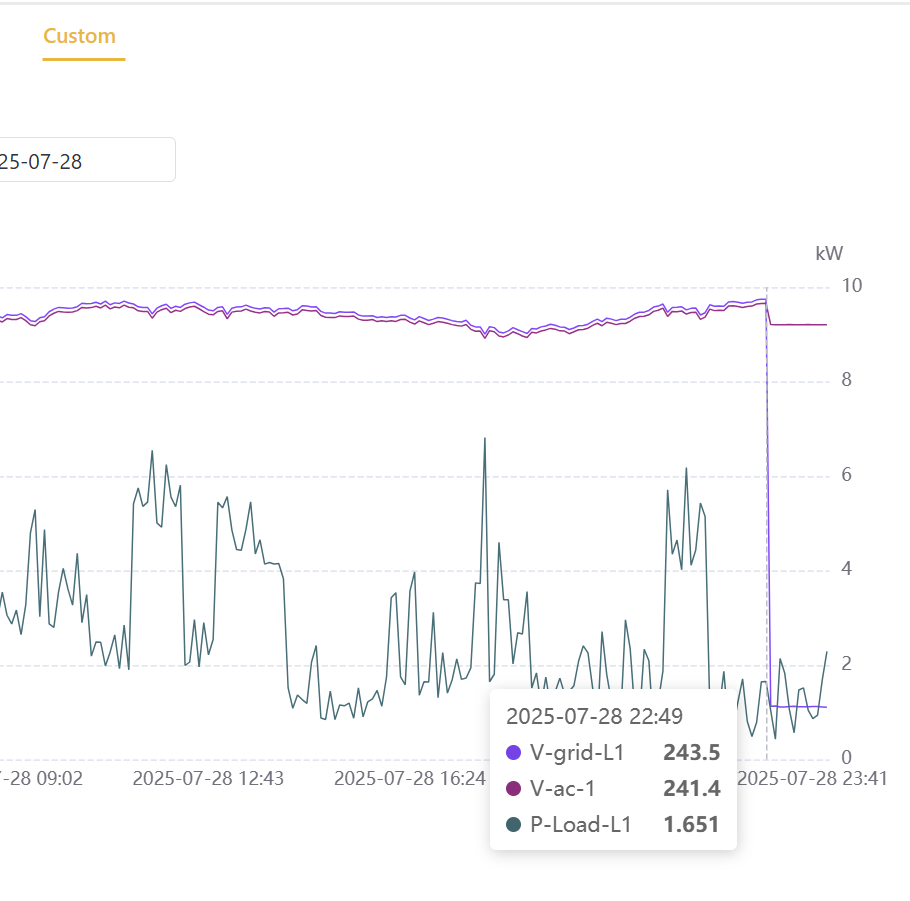

it is weird for the 22:55 trips........load is not high at that point .....about 900w - 1.6kw (see screenshots below) ......had a trip during the day today aswell....it seems the trip happens when incoming voltages kreeps up over 240V.....in the 243V+ range ......
  • might that trip a breaker ?
  • the Voltage coming in drops then to 27V and not 0V ..........is that correct ?
