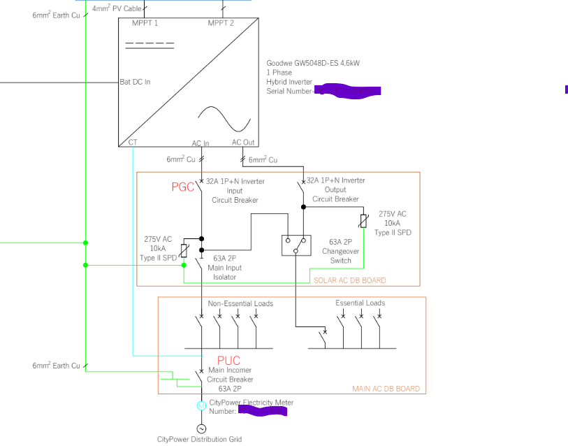

Scenario: My PV is up and running, the battery has plenty in it, grid goes down (this has happened twice this week and it's only Wednesday). At present the out buildings are on the non-essential side. What's in there? Well the laundry, a second geyser (I keep this off), and the pool has it's own little DB fed from the out buildings. When there's no grid I can run an extension lead to the washing machine, but unless I do evil things I can't get power to the pool pump. Which annoys me because most days the system does support the pool pump with no problems.
Currently I have a change over switch so that I can run the essential loads off of grid instead of the inverter. This is in a local DB for the inverter. I attach part of the circuit diagram for my system,
So what I would like is a second change over switch so that I can switch the non-essential loads onto the inverter when we have no grid. I have to manage loads in this situation. I understand that. Most of the time we will be OK. This would also allow me to check how close I am to not needing a grid connection at all.
Obviously it would need to be a 3-way switch as is currently there for the backed up loads, with the middle position being off. I think there may be a way to render myself connection less depending on the positions of these two switches, but, again, this is for me to manage and I don't think anybody's going to get killed.

This is where the plot thickens and where you need to be very careful.
The moment you start using two manual bypass switches to move loads between Eskom (utility input) and the inverter output across two different DBs, you introduce a serious risk.
If the switching sequence is wrong, you can unintentionally create a back-feed path from Eskom straight into the inverter output. That’s exactly why essential and non-essential DBs are normally isolated in the first place.
Here’s the risk explained simply:
Your essential DB bypass switch normally sits in inverter mode
(inverter feeds the loads, Eskom isolated).
You only flip it to Eskom when servicing the inverter or forcing utility takeover.
Now you add a second manual bypass on the non-essential DB between Eskom and inverter output. If you unknowingly leave essential DB bypass on Eskom, and
Non-essential DB switched to inverter output you’ve just created a direct path from Eskom into the inverter output. That’s how inverters get destroyed.
There are only TWO safe and viable options:
1. Move the required loads from the non-essential DB to the essential DB
Simple, safe, no extra switching logic, no risk of back-feed.
2. Keep the essential DB bypass as-is and use an AUTOMATIC transfer switch (ATS) on the non-essential DB Eskom is wired as primary. Inverter output as secondary
The ATS only changes over when Eskom fails. No possible feedback path between inverter input and output
OK. This is the sort of scenario I was concerned about. And I think this COULD happen. Eish...
