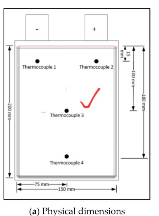

Place the thermocouple on the side of one battery, roughly mid-height or the middle battery in a stacked setup (worst airflow).

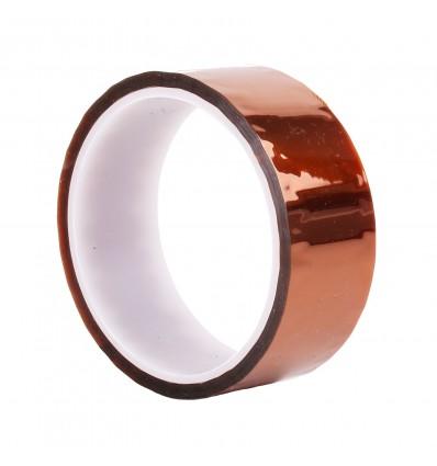

Use Kapton tape to secure it tightly and add a small piece of double sided mirror tape over it (peel only 1 side).
